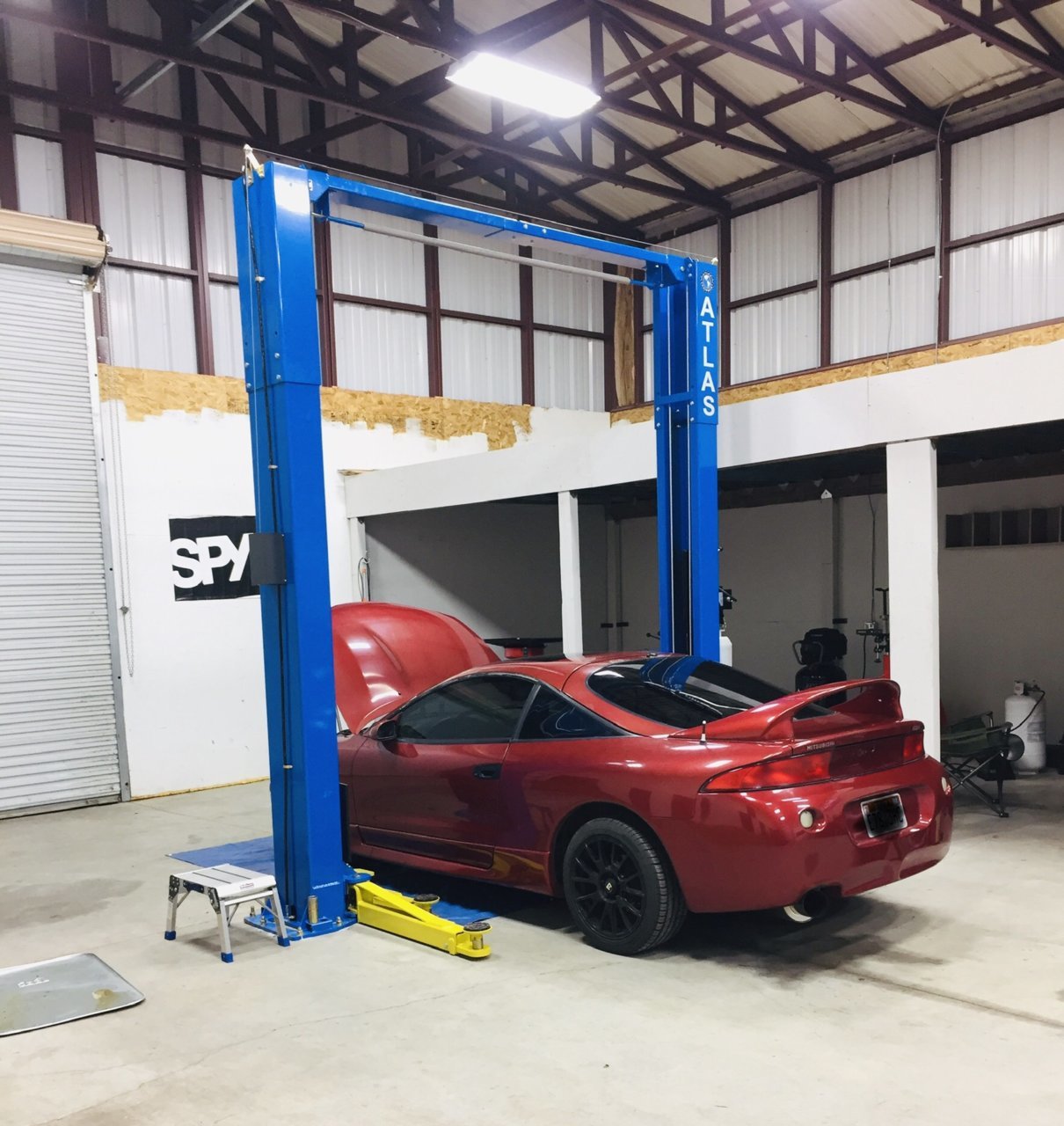

    Sounds like you have it all figured out. If it wasn't for your motor home I would definitely recommend a two post lift. I paid around $3,500 for my two post Atlas lift (10k), and its one of the best investments I've ever made!

    Wow - sounds like way too much work. Just go with a two post, you will thank me later!IMG_1461.jpg
