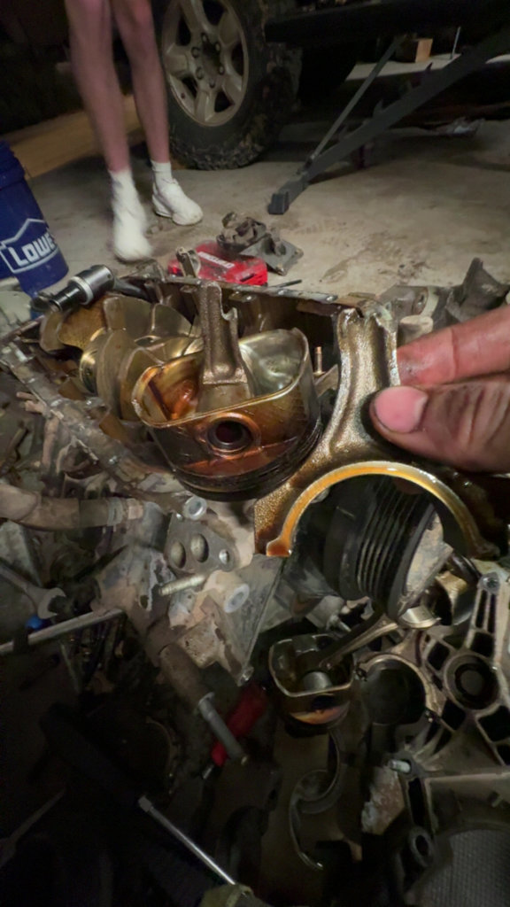

    blew up engine:(

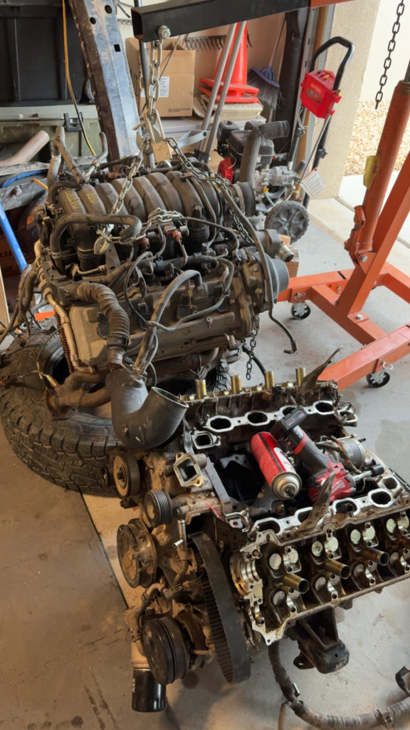

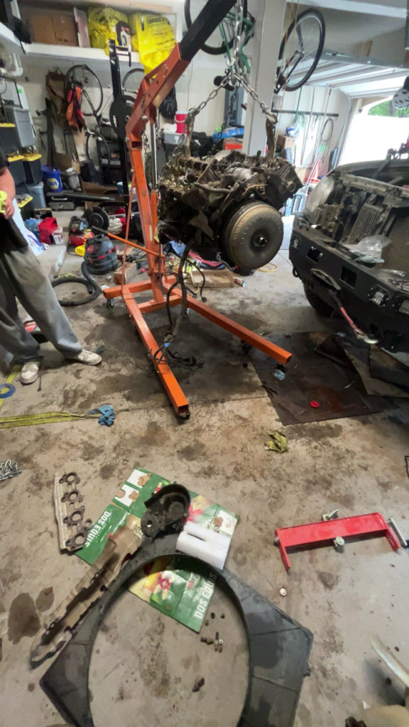

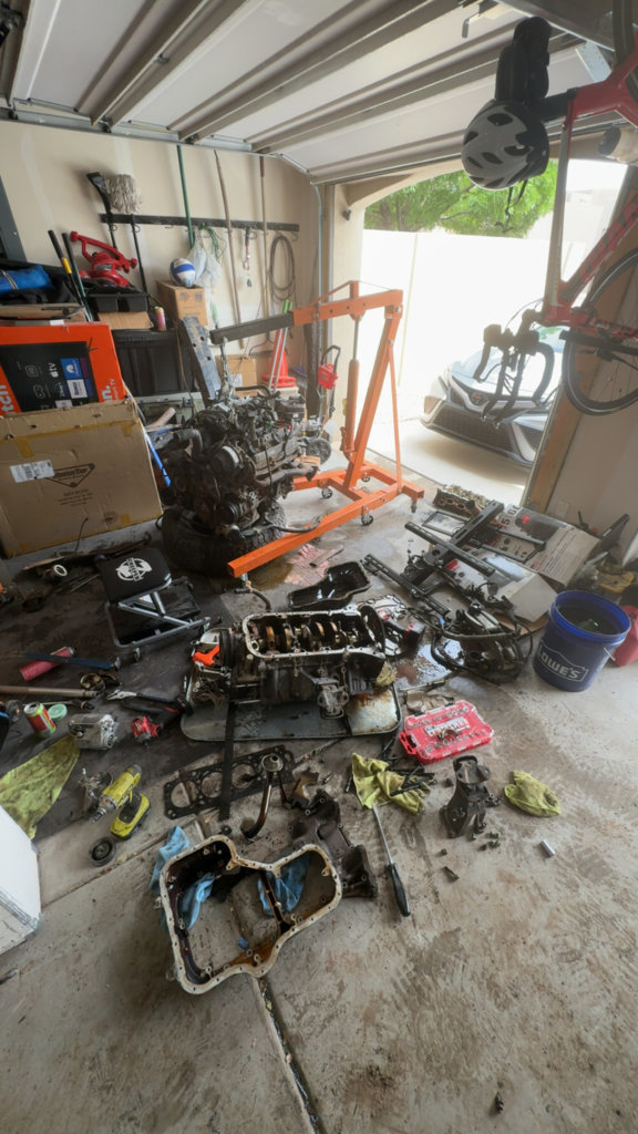

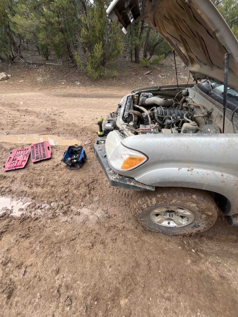

    About a month ago I unfortunately sent a rod through my block and decided to replace the motor in my garage. After many many hours of work I have the replacement engine in but am getting a crank no start. I don’t know a whole lot about the new engine it is from a 2005 sequoia it supposedly has 240k miles and my truck only has 187k. The place I bought it from said the compression test showed a range of 150-170 psi all around. When I turn the key there is about 2-3 seconds of what sounds like it wants to start but it doesn’t. The rails are getting fuel and the crank and cam sensors look fine. Currently stumped looking for some advice.IMG_3308.jpg IMG_3312.jpg

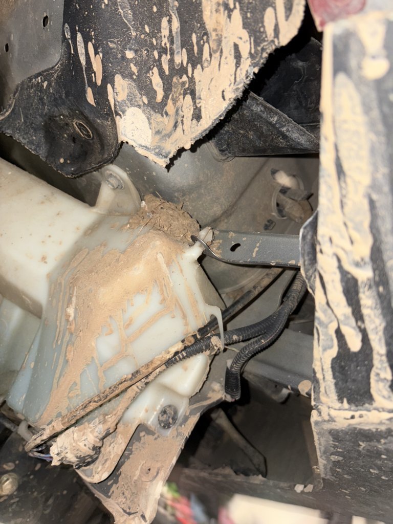

    It has unfortunately been an extremely painstaking process. The only work I had done to the truck prior had been the bumper and the I put bilstein 5100s all around. The truck had died as I blew through a decently sized puddle with my foot to the floor. It shut off about halfway through and I heard a splash underneath. I then Popped the hood and took of the intake pipe and peeked into the throttle to see it full of water. It appears that when I was trimming my fender liner for the bumper I had cut it too high below the intake hole. So all mud that my tires were slinging went straight into my intake.

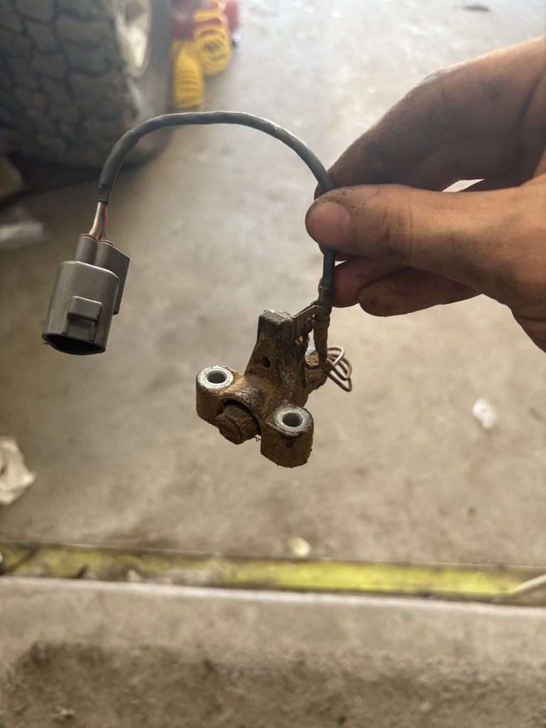

    I just realized that I did not replace the cam sensors. I replaced the vvti and crank sensor but I did not do the knock sensors or cam sensors. I wonder if there is a way I could narrow down which one because both of those look like pretty tedious jobs and I would rather not have to do both. All the grounds are on I had a couple people double check and I don't think thats the issue.

    No fender liners or improperly trimmed liners have been the source of basically every major engine failure here other than the timing belt. It doesn’t happen a lot but it happens. Y'all check your fender liners before a puddle turns your engine into a brick.

    Knock sensors won’t cause what you’re seeing, I’d get that out of your head. At worst you’d go into limp mode after starting. Cam sensor can be replaced easily without major disassembly, as can the VVTi solenoids on either head, top of cam tower, on the edge pointing toward the intake.

    Sorry I haven’t responded been a busy few days. I used the original harness and used the throttle from new engine. I finally pulled the code and i just got a p1340 and p1330. About to get started on taking those cam sensors out.
