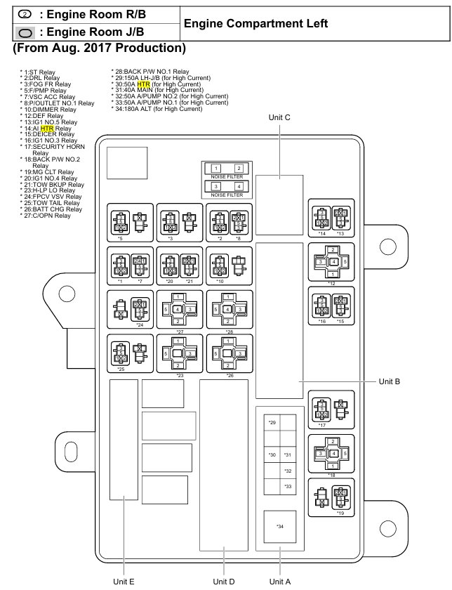

    I need to get to the fuse shown in the attached.
    however its not as easy as removing like the others.
    how do you remove this fuse?

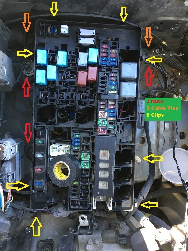

    I for sure would start by removing battery considering the clips and what not that have to be accessed. While the below video is about 07-16 Tundra, the procedure is very similar. It's not the best video and some steps for sure don't pertain but it should give you a good idea. Hopefully you have done some checking to make sure that is in fact your problem. Blowing a 50 amp fuse is pretty rare.

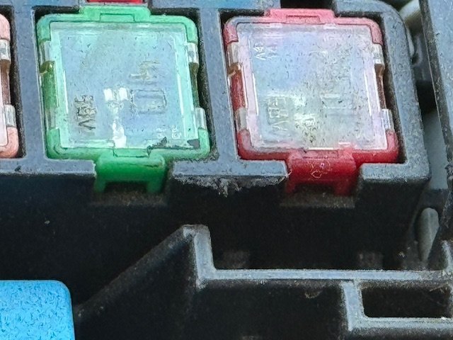

    I think he wants to replace the 50AMP HTR fuse, not the main fuse.
    Does that require taking the fuse box apart?
    It looks like a J case fuse.

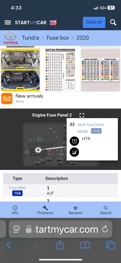

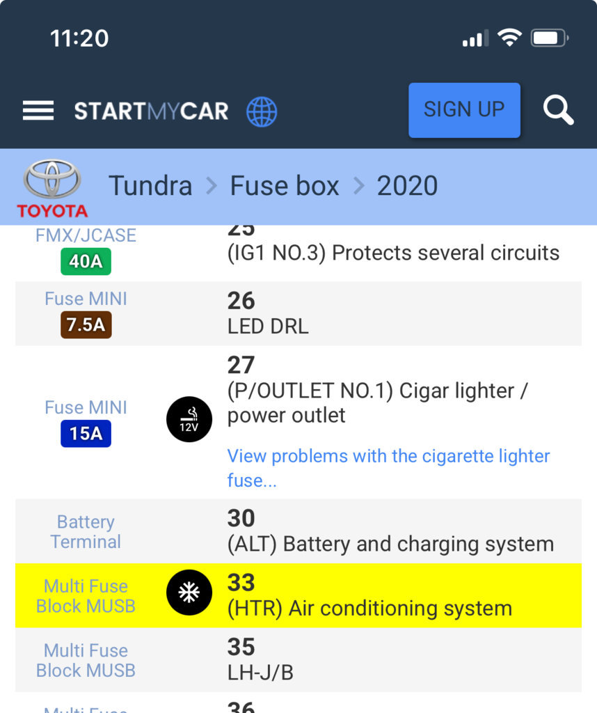

    Not according to the item it’s focused with circle and line in the picture, item 33, that is the multi fuse block. He’s also chose 2020 Tundra, whereas your picture is referencing a 2017. They’re similar but not totally. Perhaps Thomas will return and confirm.
    https://www.startmycar.com/toyota/tundra/info/fusebox/2020#anchorfusebox0
