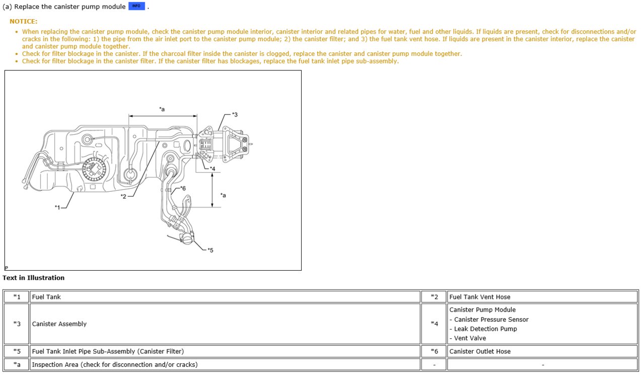

    Heah guys, every time i pump gas it keep stopping as if its full i chaged the charcoal condenser and still having the problem nothing came on the computer no check engine light any idea what might be the problem?

    It's a long shot but have you checked all the hoses?
