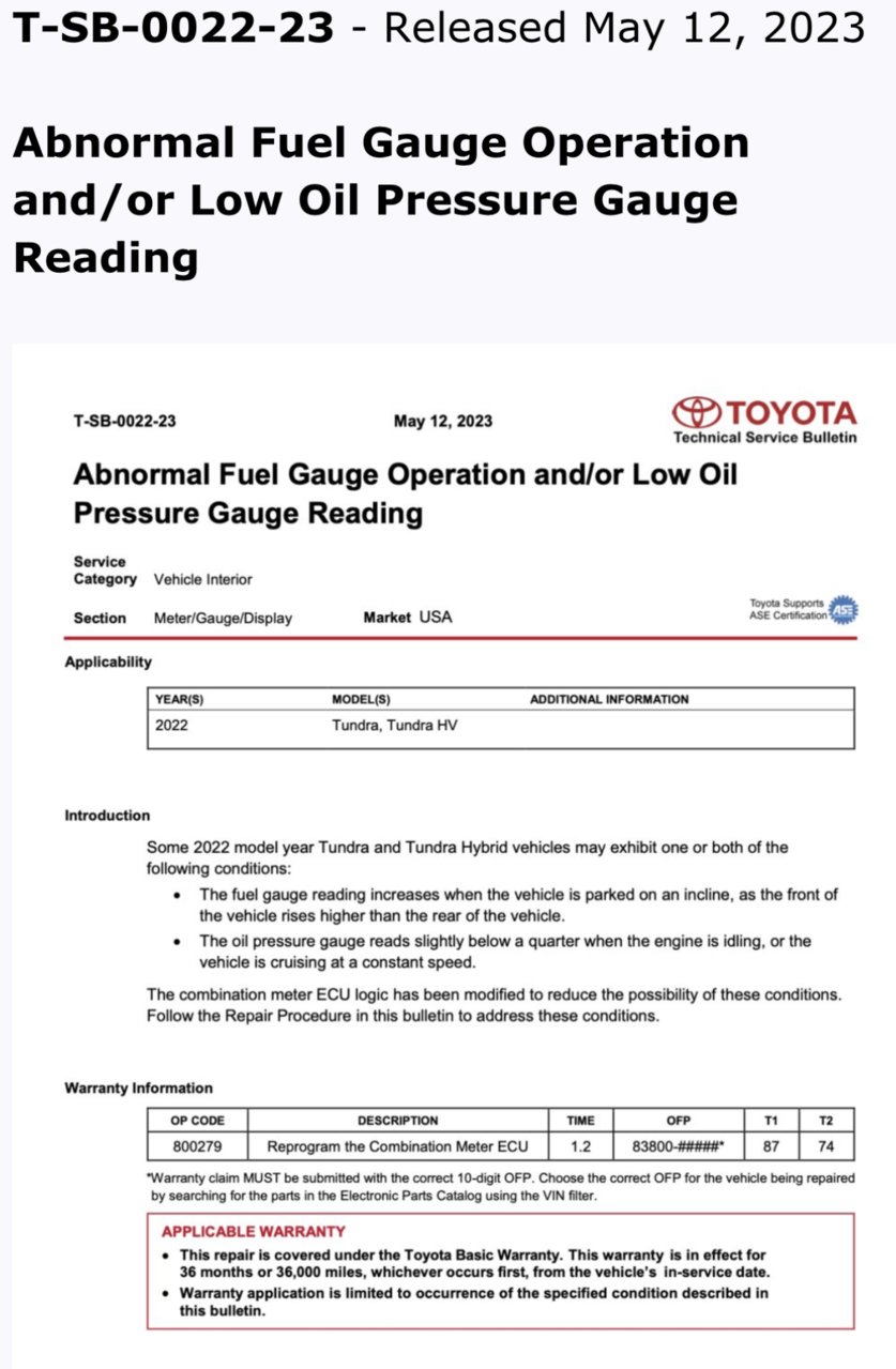

    Could be related to this

    So 16.3mpg x 32ga = 521. 425 indicated to go plus some reserve. Sounds right. Only issue I see is that outside temp lol
