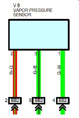

    I need color code for a 01 Toyota fuel tank pressure sensor harness

    If you're speaking of what Toyota calls vapor pressure sensor at fuel tank, the below should be the conductor colors for your 01.
