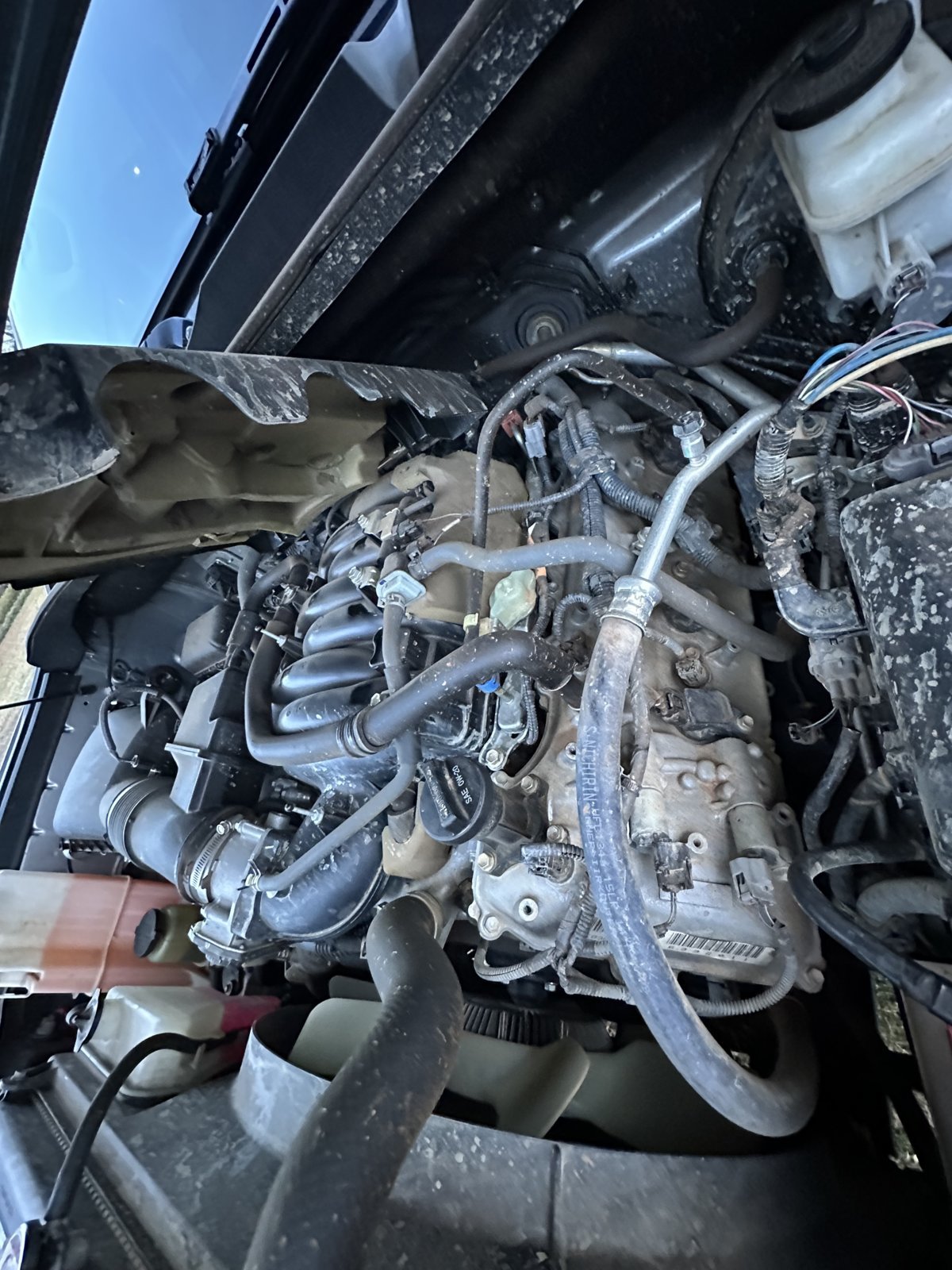

    Hi
    I’m unable to find the “fuel rail” on my 2018 5.7 Tundra. I believe it is this area but not sure where it is. I can’t find any comprehensive videos or guides on checking fuel pressure on the newer trucks 07+ I can only find literature on the older model 06 and under. I need to test my fuel pressure so I can trying to locate the fuel rail. Can anyone point me in the right direction?
    Thanks

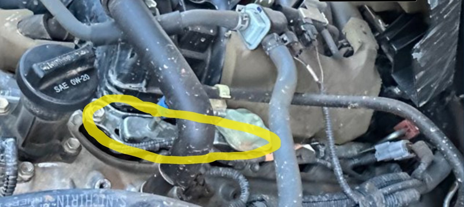

    29,523
    I believe this is it.
