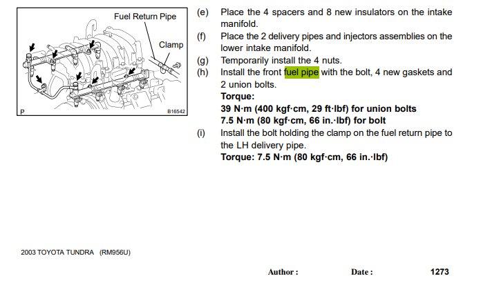

    Gents,
    The FSM says 29 foot pounds. Seem like an awful lot. I've got 25 foot pounds on them already and I'm hesitant to do more.
    New crush washers, if it matters
    Any advice would be greatly appreciated.

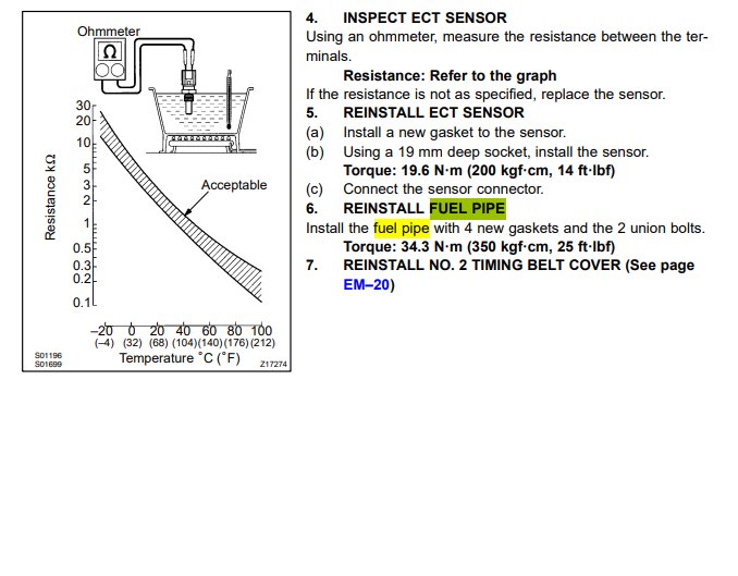

    Are you doing this one a 1st gen or on your 2012? Our FSM calls it a fuel delivery pipe. Go with what the manual says. Here are the specs...
    2UZ
    5VZ

    Doing my 1st Gen Sequoia. It just seems like a lot...
    Thanks much for the detailed reply.
