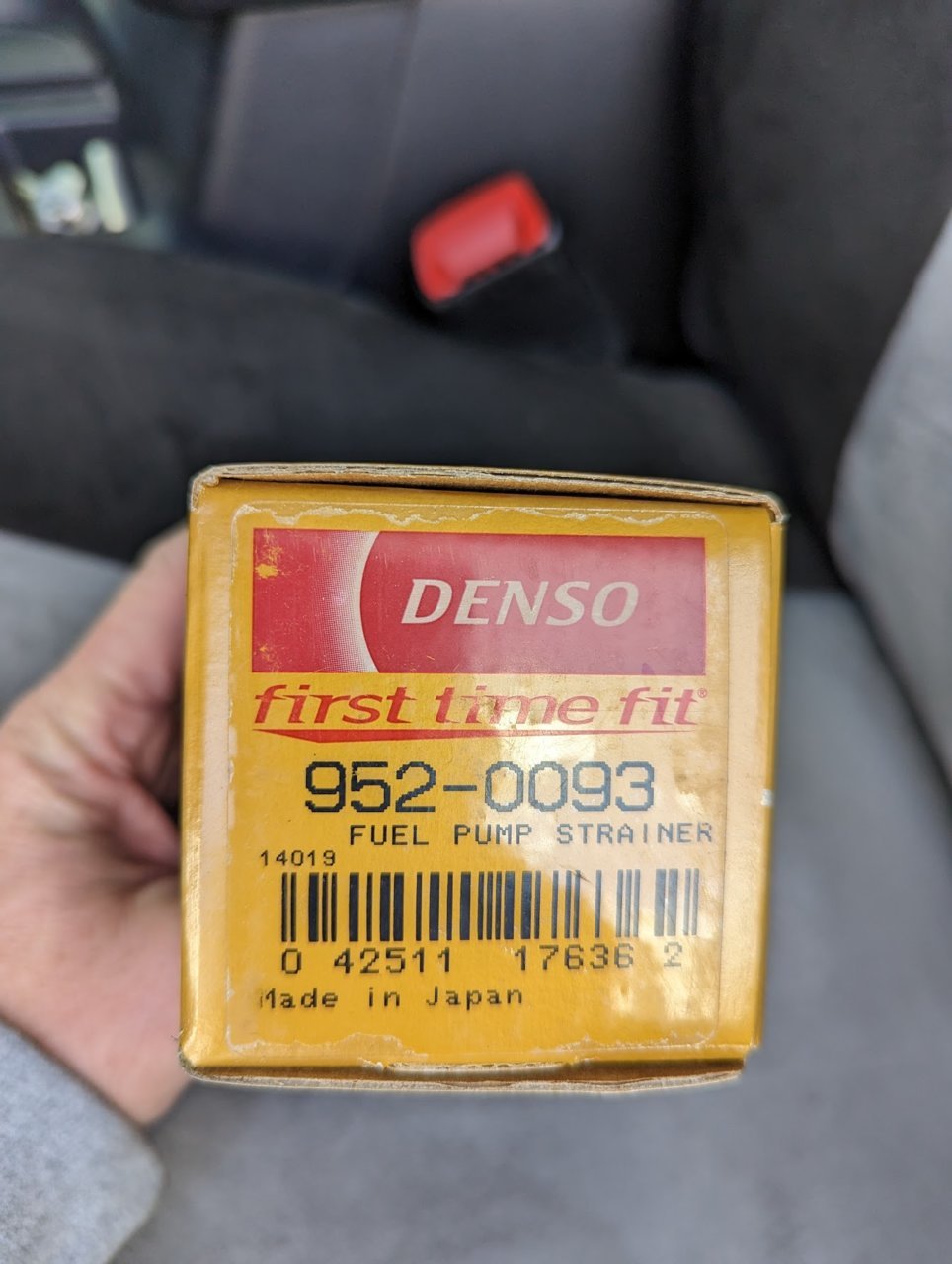

    Part number for the in tank fuel strainer (filter):
    wK86vFP7TSpTmV5n6s-AdgIAaNDqWTM942dha6CD_e328fc1a77d61472bcadcc22ef91ee7596477bf7.jpg
