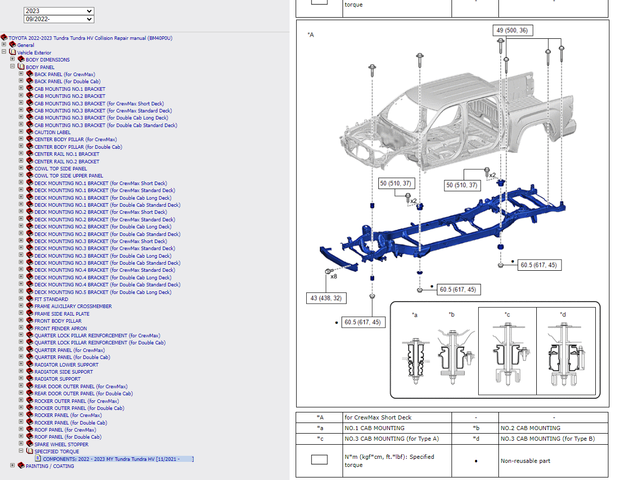

    Looking to find the torque specs for the bed bolts (giant torx bits). about to assemble a fridge base plate/storage setup and curious if it's out there somewhere.

    I believe its 30lb-ft but i cant find the info anywhere.

  4. Jun 10, 2023 at 8:17 PM
    545moose
    545moose [OP] New Member
    May 14, 2023
    #97015
    65
    Jon
    23’ Offroad
    Marvelous, is that TechDoc, or that's what I think it was with Lexus; I'd assume it to be the same but not sure.
