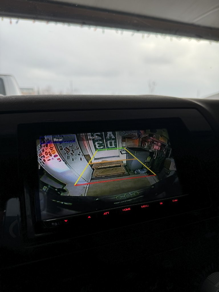

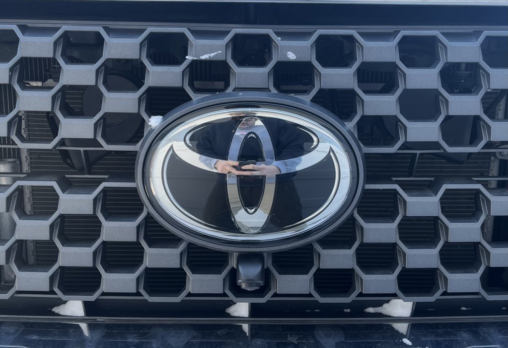

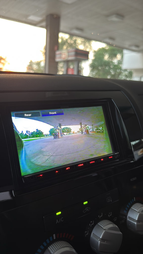

    I have the kenwood dmx908s in my 2nd gen with the kenwood cmos 320 camera for the front and master tailgaters tailgate handle replacement camera for the rear. They both work great with decent enough picture quality to be able to make out objects in both day and night situations.
    I've also just recently added the kenwood cmos 230 camera onto my first gen sequoia with the a similar pioneer headunit (the 1770) and it works great as well. The one caveat I've found with that is there are no backup lines but I personally don't really care as I use my mirrors to line myself in a spot like everyone else should.
    It is my opinion that so long as you can differentiate objects in front of/behind you from your bumpers, that's all you really need out of additional cameras. Getting nitpicky between camera brands and resolutions is just a waste of time. As long as you attempt to stick to the name brands you'll be okay. Most of the cameras you see for sale are all practically built the exact same with a different housing and/or lens.
