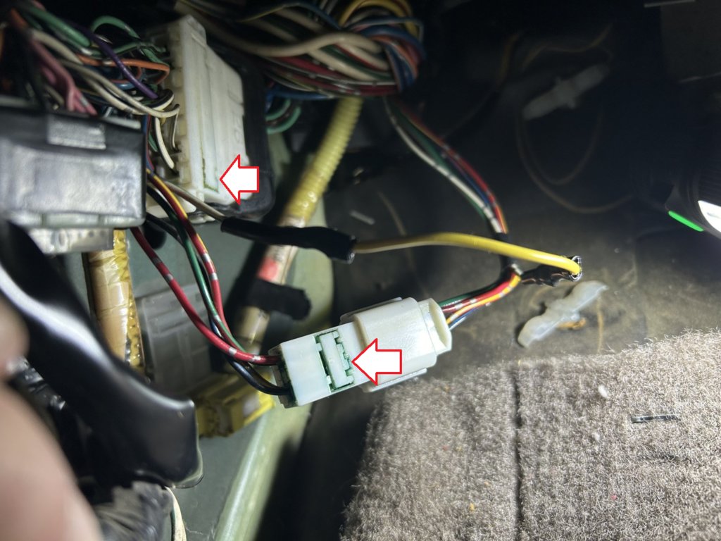

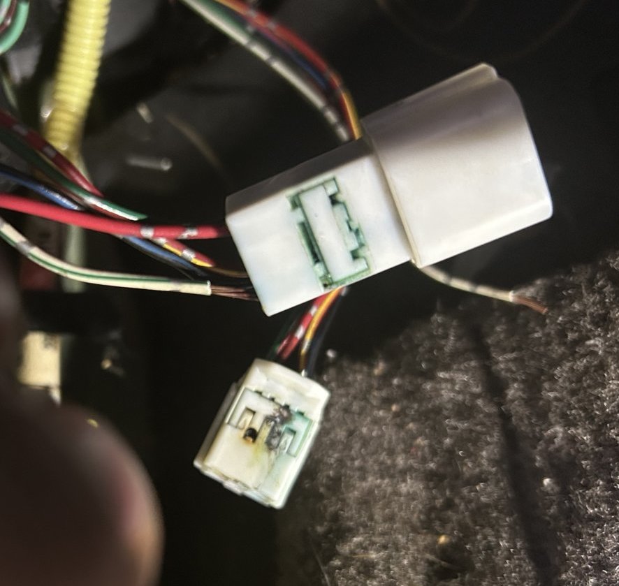

    First thing to check, click all my links in the couple of replies here to see what you’re looking for under the dash. The symptoms of “accelerator pedal doing nothing” and “noise in dash” reeks of “you have water getting into your dash, and it’s probably corroded a couple of power connectors, and possibly gotten into the fuse box as well”: https://www.tundras.com/threads/02-etcs-actuator-ground-location.99313/#post-3913132
    A lot of people will see “clicking” and “4WD” and go to CV axle. I don’t think that’s the problem here if clicking is in the dash. Clicking is the sound relays make. You have relays in the dash.
    I’m stuck on mobile at the moment so I can’t mark up the picture I want to. May come back and add it later when my internet is back up again.
