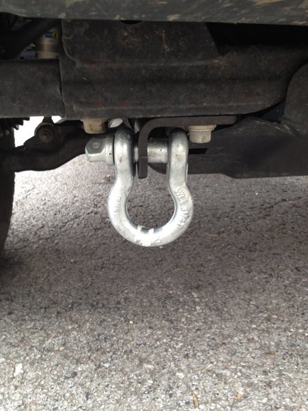

    So I just noticed this on my 2006 Toyota Tundra SR5. There are no recovery hooks or anything in the front. I see two holes in the frame but that is it. Should I add two D-Ring shackles like the ones pictured or is there anything different I should add? Bumper has no knock out access points either.

    That is not for recovery. That is for tie down on a flat bed. I take it that’s not your picture but what’s depicted is incorrect and dangerous.
    Darkness likes this.

    No that is a picture I pulled from Google. The holes I am referring to are actually in the frame itself and not bolt on additions. I am just wondering if a D-Ring put thru the hole in the frame would work?
