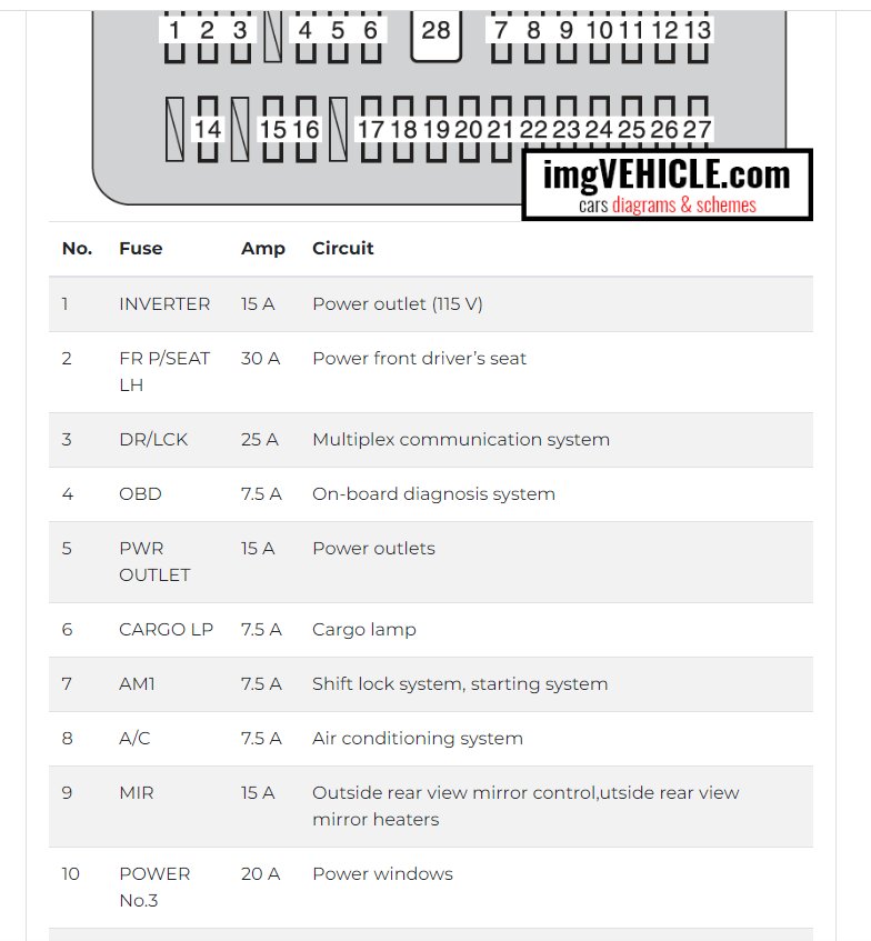

    Hello, my front passenger window stopped working with the main switch and passenger switch. The other 3 windows are working. So I bought a new main switch and same issue.
    Is there a fuse for the passenger window maybe? I checked under the hood and under the dash but didn't see anything related to the window.

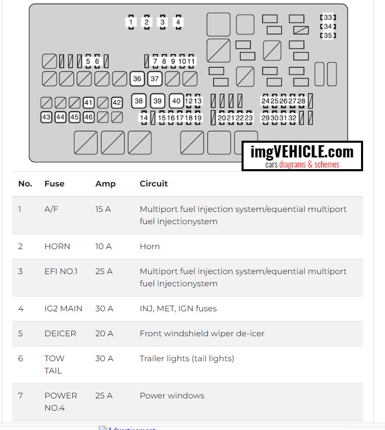

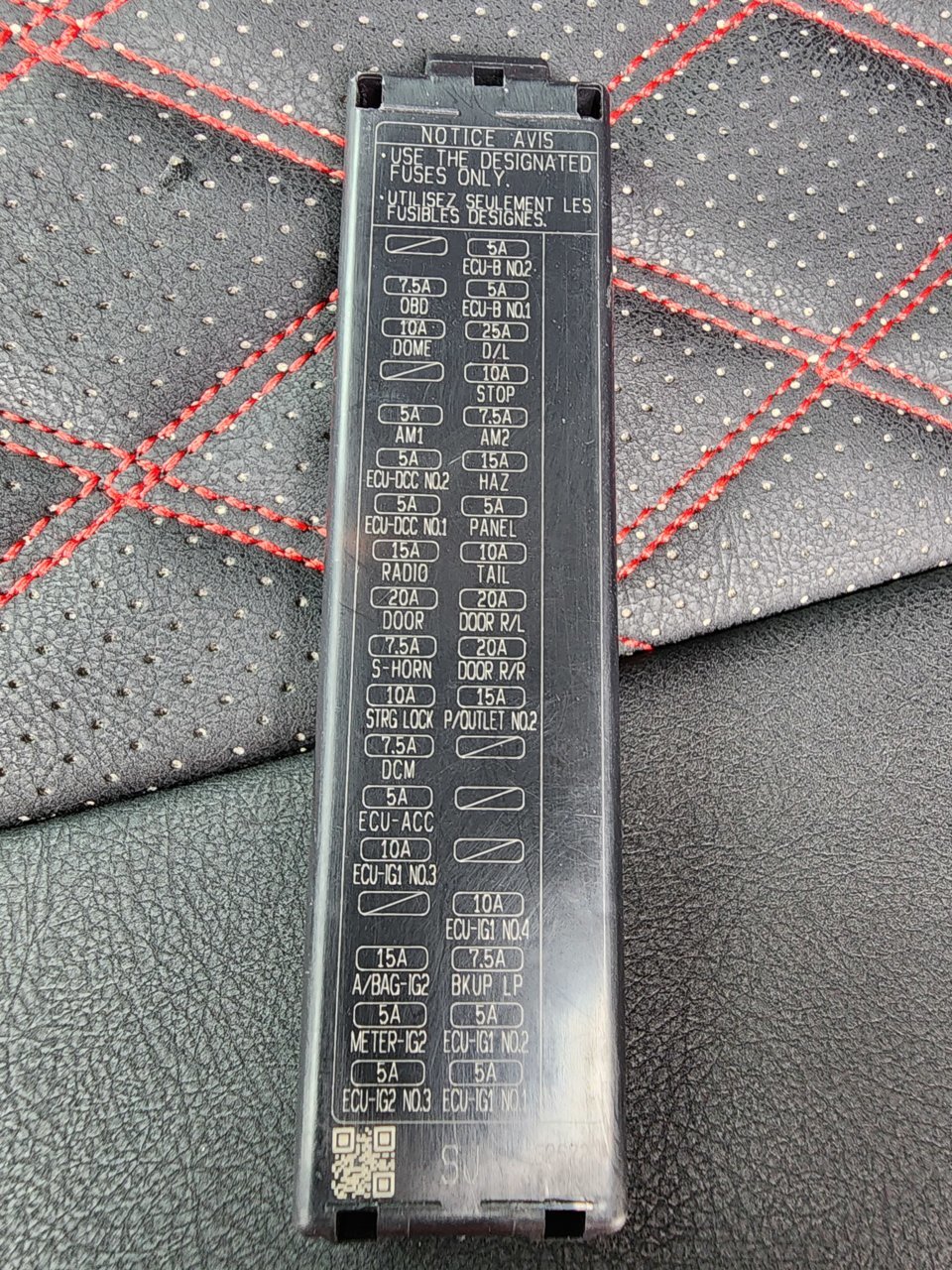

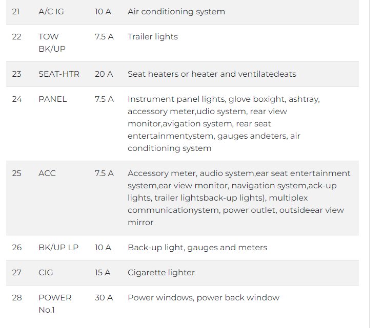

    In the engine, check Fuse 7 (pix). In the interior, check Fuses 10 and 28 (see pix)

    Hmm my fuse looks a little different. I have a 2020 sr5.

    Sorry, that was for 2007 - 2018. Maybe the DOOR fuse?
