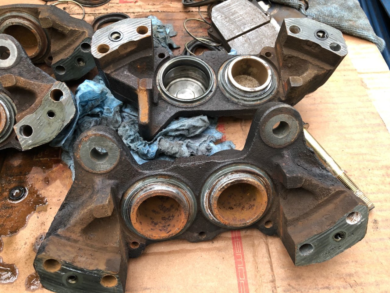

    Secondly, good job setting priorities. Brakes are the most important. With money tight, I’d focus on the front Calipers/Pads. With yours being a 2000 model, its probably time to buy new calipers and shoes and do a full brake fluid bleed. Our 00-02 came with the smaller WE13 calipers and you can upgrade to larger WL13 if you want as they cost the same. At almost 20 years old, some of the pistons can be seized up.
    If you have any extra$ then rebuild the rear brake drum cylinders and put new shoes on back there if needed.
    Save up and do your suspension another day in another phase. Brakes are the most important thing right now. The fronts do 70% and rears 30% of your braking.

    Old and tired 2002 WE13 calipers. Danga danga!

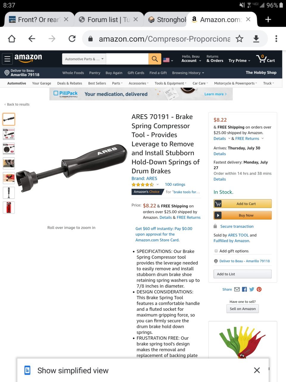

    I concur. Brakes first, and a 13WL swap. Also, get this tool or similar for the rear drums. You'll hate it a lot less.

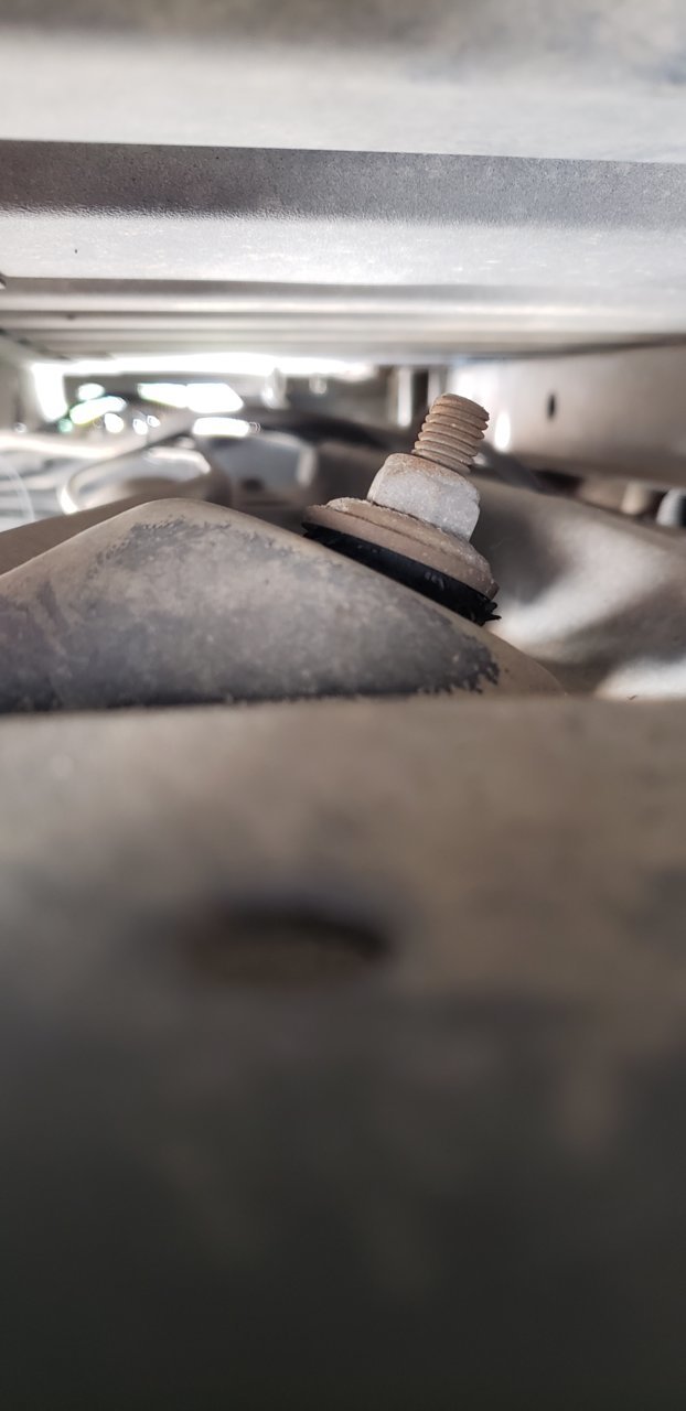

    You have to remove the bed to change shocks?
  12. Jul 25, 2020 at 7:19 AM
    bmf4069
    Sep 1, 2018
    #18880
    9,533
    Beau
    TX
    02 AC sr5 4wd v8
    You don't HAVE to, but it makes it an easy job. That top nut on the shocks is about an inch below the bed.

    I concur with BMF, rear shocks on first gen sucks. I had to cut the boots off and grind flat spots on the shaft to get a proper grip and get the top nut off with a box end.
    2nd/3rd gen has way more room for tools, probably a 5 minutejob on those trucks.

    Might just depend how stuck the top nuts are, if my nuts came off easy it would be cake. Block lift won't make a difference, it's spinning a nut where the shaft spins too in the tight space above the frame that sucks.

    yep. you're right. Although I maybe I just have small dentist hands and didn't have issues with the top nut. a ratcheting box wrench helps a ton too

    I just took a peek at the upper end of the rear shocks. I may have to do that, I have biscuit hands with Christmas tree fingers. Thanks for the heads up
