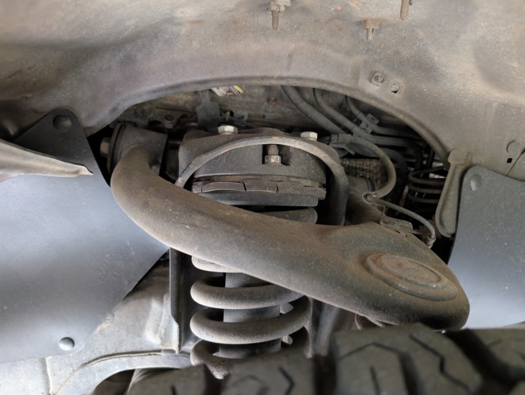

    Purchased 2015 1794 edition not long ago. This is a front leveling kit, correct?
    I think it's 2 inches. Getting in 17 inch wheels tomorrow, can I fit 285/75/17s? Or should I go with 285/70

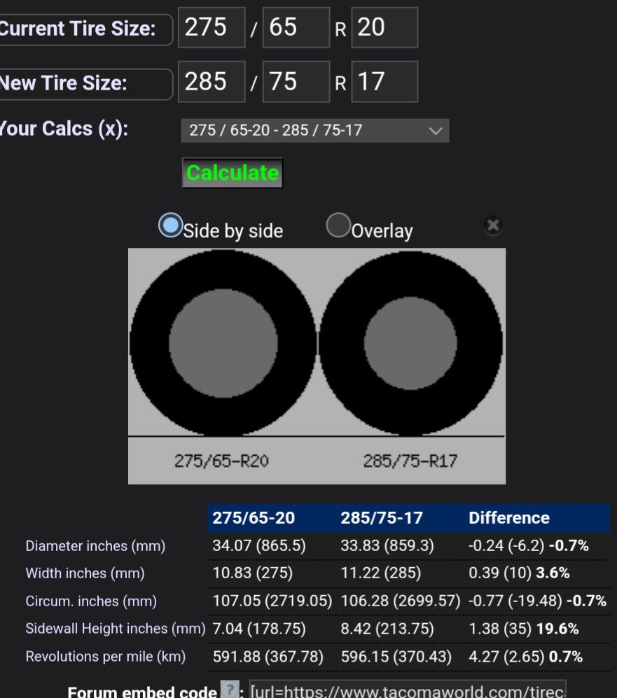

    The 70s are 33s and 75 are 34s. 34s will probably rub mud flaps at full lock. Pic is a spacer block. Looks like 2".
    Will 17" wheels clear your calibers?

    Measure the lift pucks. You get about 1.5x that in lift. 2” block gives more like 3” lift. Chances are that’s all original suspension and needs to be replaced anyway. Ditch the blocks for better hardware if you want to keep it leveled.

    Maybe in the future. Not in the budget for be suspension right now

    I have 275/65/20 now. Looking at this comparison the 75s should fit. 70s would be an inch smaller
