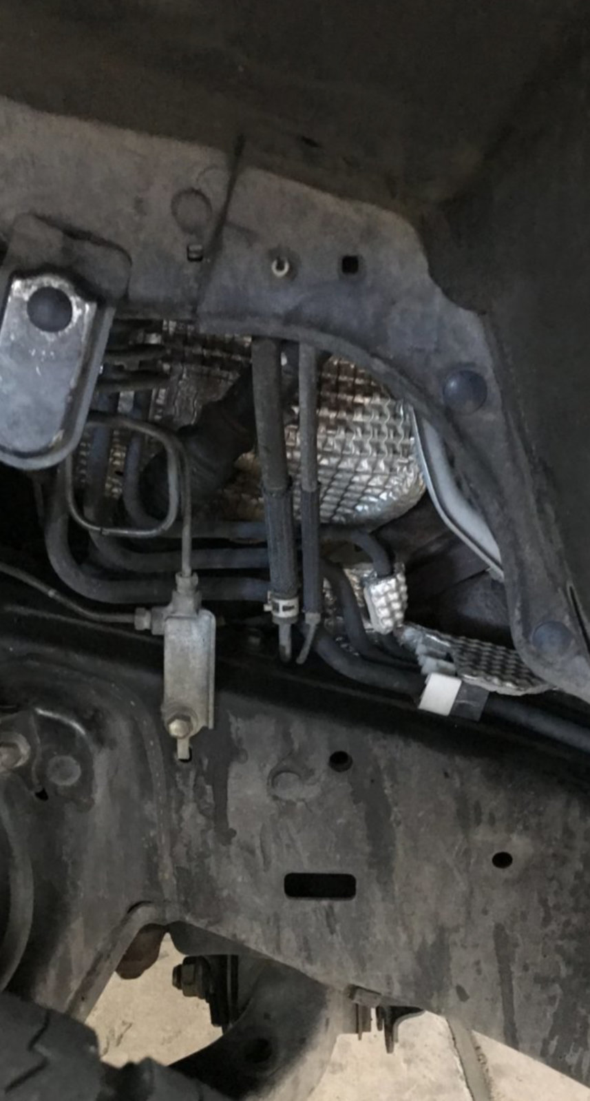

    I have a 2008 tundra and my dog decided to chase a squirrel up under my front left wheel. He ripped the rubber seals off along with the abs speed sensor cable and these 2 dead end lines. Can anyone tell me what these are for and where I would find them for parts? I found a picture from another forum of where they should be installed but I want to know if I should get new ones as there is a couple small holes in these now.

    Those are front diff vent tubes. Pull the vents off, clean to confirm they're not clogged then just replace the rubber hoses.
