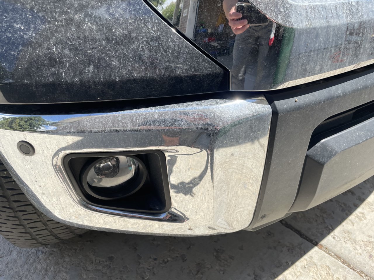

    I wish I could blame it on the wife, but this was all me....long story...
    Anyways....
    I have a lease I have to settle soon (probably trading it in), and I am looking for the cheapest way to repair this damage. It's just the passenger side front chrome bumper (sensors still work fine) and the plastic middle piece. I went to a body shop and was quoted over $1200, which seems a little excessive. I've been thinking about just going to the dealer and seeing what it would cost them to replace the two pieces. I was also wondering if perhaps a novice like me could order these parts and try to figure out how to install them.
    I was just wondering if there is any advice you could offer me on what route you would take with regards to repairing this damage. I want it done right, so the next owner feels doesn't have to deal with it, but I'm all about saving money in todays environment.
    Suggestions/Input/Advice appreciated. TIA
    (It's hard to see in the pics, but the chrome is noticeably dented at the bottom right. The plastic front bumper is buggered up at the bottom left. It looks worse in person)

    check facebook market place and the likes to get the end cap, cheap. and as far as install, This video gives a good way to do it, and thats how I do, and have done it . not my stuff, but here is the link. https://www.youtube.com/watch?v=ku9ydEnLnpU

    Cheapest thing to do may be nothing at all. The damage is minor. You could have a “pre lease return” inspection to ask them to identify any issues that may need to be resolved to avoid penalty before turning it in. You could even ask what the penalty would be if they point out your damage. Otherwise the Chrome end caps should be plentiful around here. Surely someone would kick you one collecting dust post chrome delete.

    Plastic, if not torn, can be bent back with heat gun, just be careful not to overheat it. And bumper cap you can buy aftermarket one on ebay for $80. Easy fix if you can wrench a bit.
    Just checked ebay, so $80 is without sensor hole, and with sensor hole is $130

    Definitely going to try to self fix. I'm not a great wrench, but I'm not horribly incompetent either. Beats the hell out of $1200 from the body shop. Thanks for all the help.
