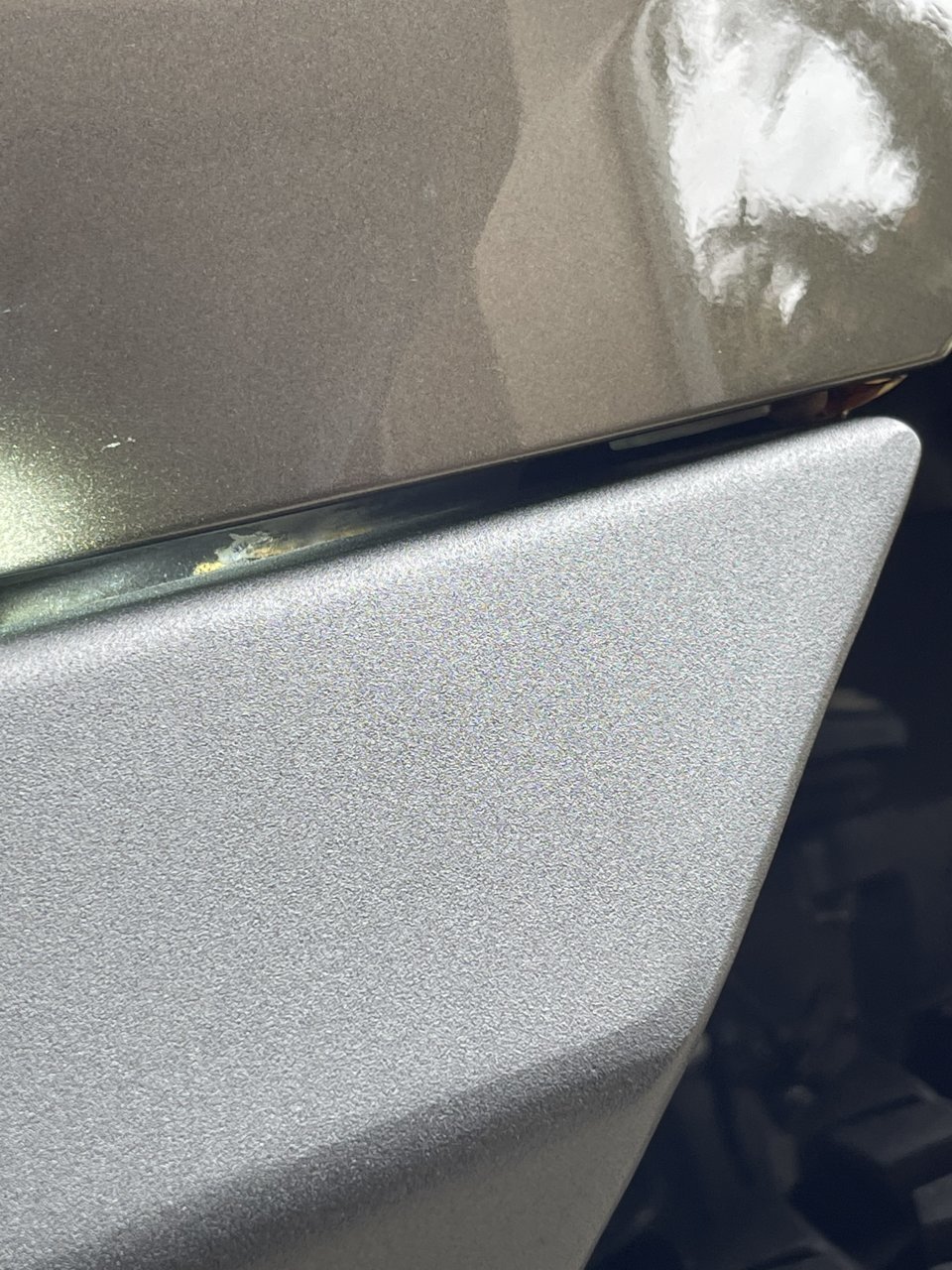

    So this is a bit of a necropost, but throwing this out in case it ever helps someone else out.
    Something that I didn’t add in my original post (because it didn’t occur to me, or anyone else along the way) was that when I had the lift installed, I had them throw on a Road Armor bumper while everything was apart. Lo these many months later, we finally discovered that the bumper was *this* much off center, causing it to rub against the sheet metal below the headlights when the body flexed. Almost nothing to clue you in visually. Took a long, thin flathead and gave that sheet metal a couple good strikes with a mallet and sweet silence ensued.
    Suspension shop guy said he didn’t know how I dealt with it so long, as that sound transferred right up the body panel into the cab.
    Anyway, moral of the story is don’t get tunnel vision when searching for mystery gremlins.
    Photo of the nearly invisible rub: (This is drivers’s side, just above tire for orientation.)
