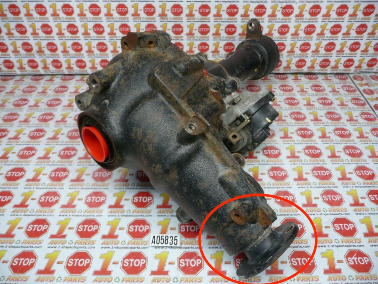

    Since I'm going to have the engine out for replacement I'm looking to solve this issue of play within the front differential. I just want to know if anyone has any suggestions as to what it can be that's causing this play. I have attached a picture showing where the play is.

    bad pinion bearing? never had one with play there.. usually they end up with bad needle bearings..

    I'm with empty_lord on this. I suspect a bad bearing.

    You could also have a bearing going out as well.

    that might very well be needle bearings ECGS makes bushings to replace those... can do them in the car.. but they usually cause vibrations well before noise

    So the pinion bearing would not be replaceable without opening up the whole differential correct? Along the way of removing the engine and replacing parts I have already changed the needle bearing with the ECGS bearing. I was hoping the pinion bearing would be that easy but I dont think it will be :/
