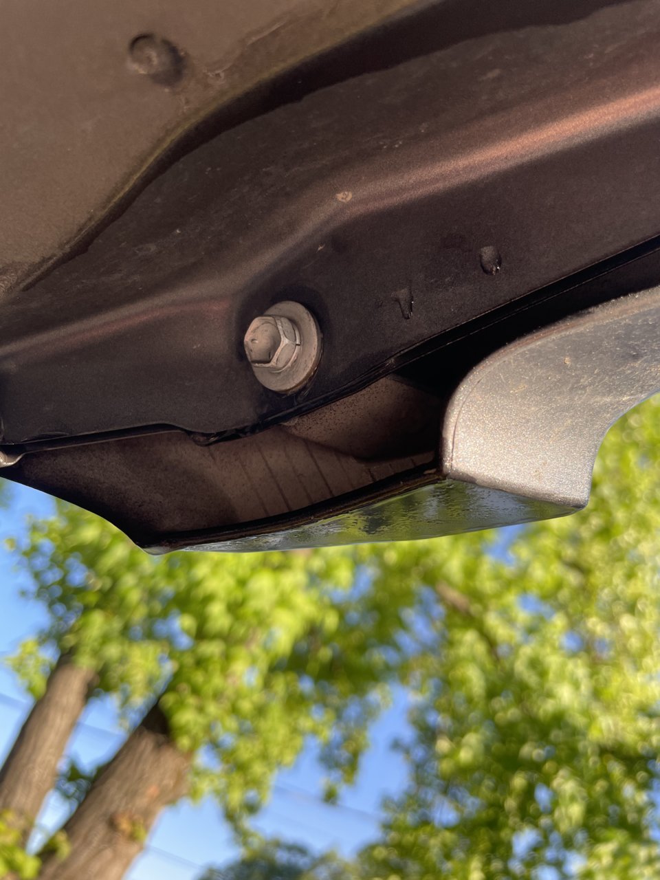

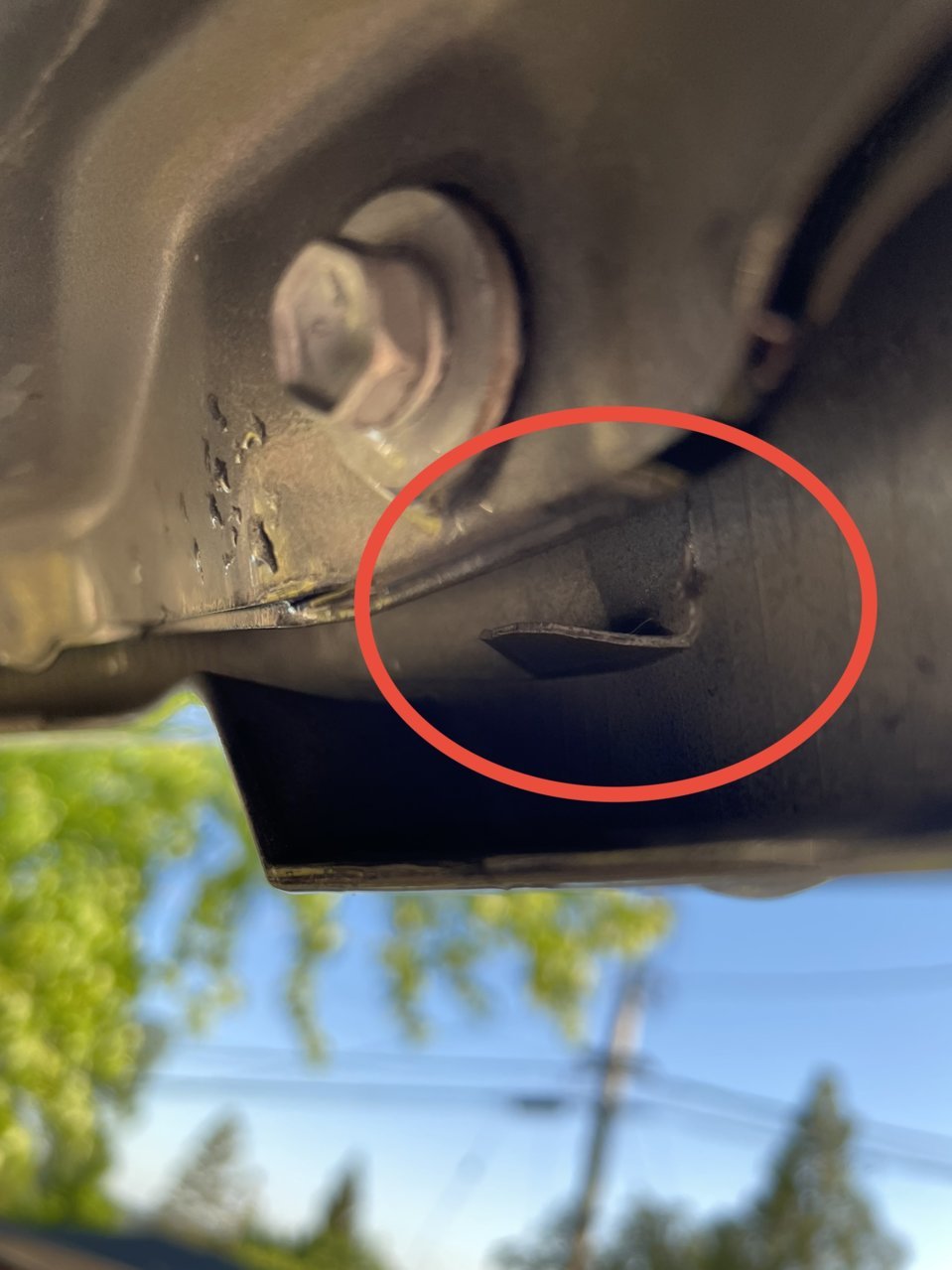

    Well, one rattle found anyway. While washing the truck I found the upper trim creaking.
    The plastic tab behind the 10mm bolt was broken off. Some foam tape behind the 10mm bolt with metal plate fixed it. Hope it helps!

    Here is a picture of the broken tab.
    Here is a picture of an intact tab.

    This exact this just happened to me, except that the tabs on each end broke and it was causing the hood bulge to pop up. Right now I just have the middle screw holding it in place but plan on fixing he tabs w/some JBWeld, I hope it works..
