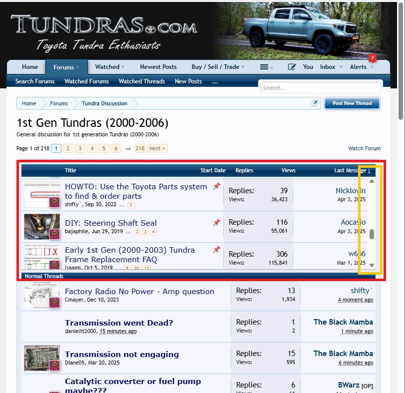

    At the top of the forum list, under the 1st gen subforum, there's a box with "sticky" threads, those are the most-important threads we have, which answer probably 75% of the questions anyon could ever possibly have when they come here.
    Notice the orange box, there is a scroll bar because there are a couple dozen of them. One is visible in this picture, "DIY Steering shaft seal" and it covers a problem many of our trucks have where engine bay noises are able to freely enter the cab. It can come on suddenly, when the seal disintegrates.
