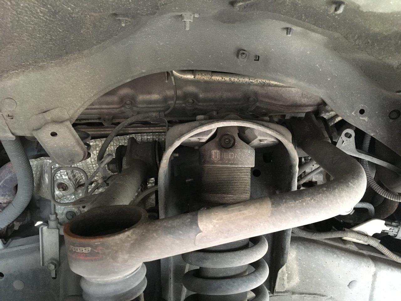

    So I know we have all experienced some sort of front end clunking but mine is driving me effing nuts at this point. I have a 4" ICON coil over suspension and I'm at about 104K on the truck. The noise I'm experiencing is over any pothole, rough terrain, speed bumps etc at any speed except crawling. It is not in my steering at all. It is quite obnoxious and everyone that rides with me immediately notices it. I have checked all bolts and there doesn't seem to be anything loose.IMG_1072.jpg IMG_1072.jpg IMG_1073.jpg PLEASE HELP!!!!!!!

    How many miles on the ICONS? may need a rebuild

    They were on it when I bought it at like 30K so I'm assuming probably all of the 104K

    Rebuild I’d say
    Check ball joints

    So assuming they need to be rebuilt how costly/difficult is it?

    Oh yeah those things need a rebuild. I have no idea I'm guessing for all 4 corners around $1000. Might want to consider rebuilding those UCA too they are prob beat that's about $350
