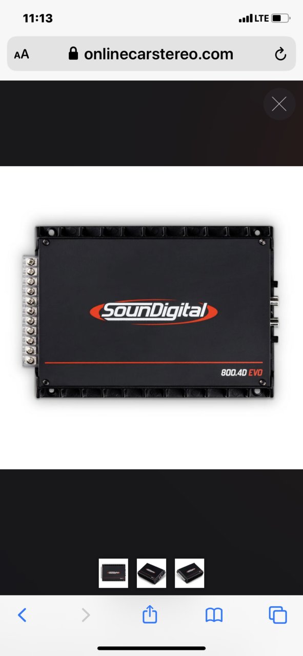

  10. Oct 22, 2019 at 9:16 PM
    DCB500
    DCB500 New Member
    Mar 4, 2019
    #27085
    907
    David
    Oklahoma City
    2019 Tundra SR5 TSS Double Cab
    Wheels, sound system, antenna, tailgate letter inserts, Grill/Hood Bulge, Exhaust, Leather
    This is what I am running for the doors and dash tweets. Very small footprint but good clean power.
