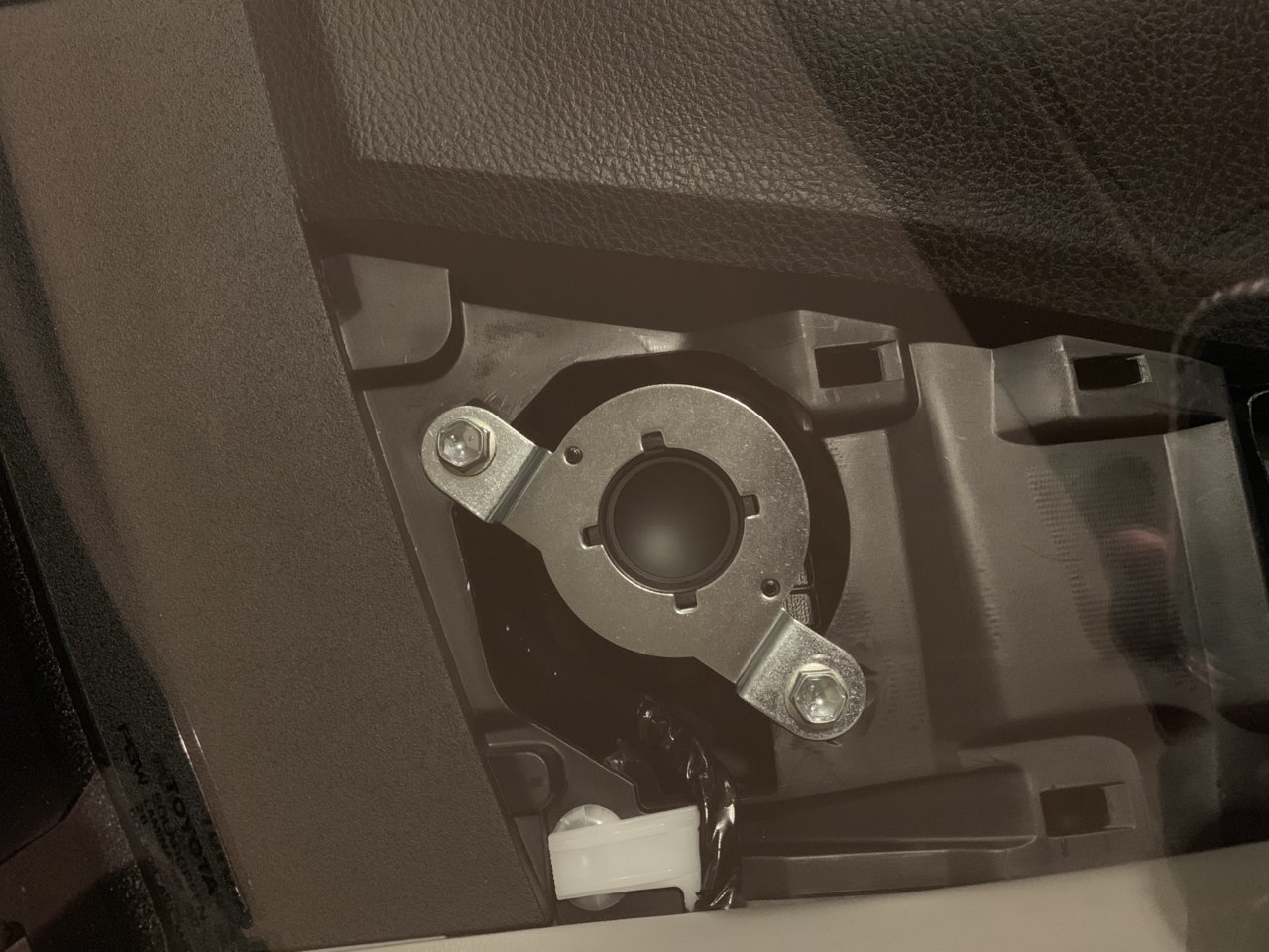

    the tweeters themselves are not bright but the brackets that come with them are....you could paint them black it it creates an issue but I have them installed and have never noticed a reflection from them at all.
