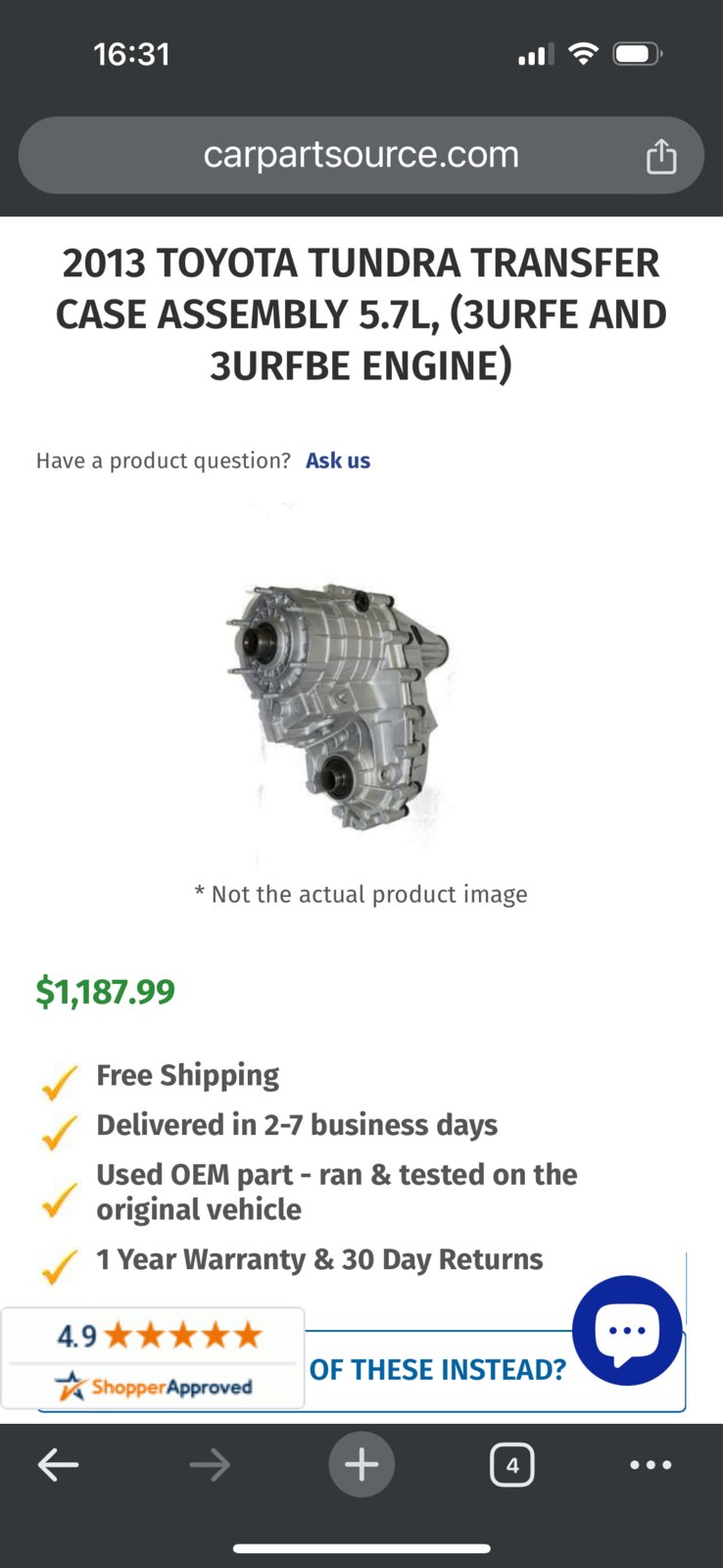

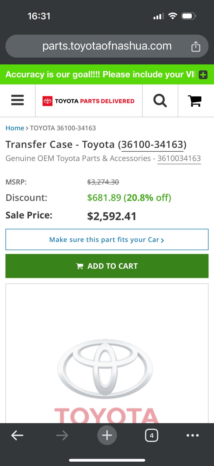

    My shop said they could only get OEM transfer case at $3,900 and the swap is calling for 10 - 13 hours and includes removing the transmission. They said they believe they can change it out without removing the transmission which should cut hours in almost half. Does all this sound right?
    I’m really interested in that Seqouia tcase swap.

    I’m trying to work the part cost down with the shop right now. I can buy new online for $2,500 from Sparks Parts and other dealers but the problem is these are in National backorder. They’re in route to the states but no eta.
    I really like the idea of the Sequoia conversion but I don’t want to put in a used transfer case. Just don’t know its history and how long it will last.
    I think I’m going new OEM, just a matter of how soon I can get it.
