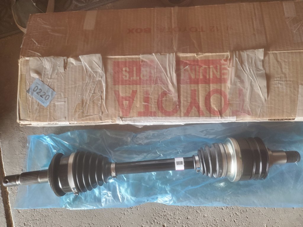

    Some good news too. New Toyota CVs are now coming available for the first gens. I couldn't find them for the longest time. I'm done with aftermarket CVs.

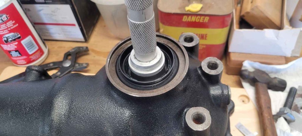

    If you borrow the ECGS bushing tool from @FrenchToasty , you can remove the old one, then tap it back in. I don't see an issue doing it this way with the OEM needle bearing. https://www.tundras.com/threads/best-gen-ecgs-bushing-tool.59664/
    If you don't want to borrow the tool, I'd just freeze the bearing, tap it in your own way, and call it a day.

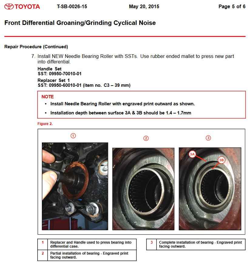

    Here's a TSB for this job on on 2nd Gen tacos that calls for using a mallet:

    Thank you! That's good info, right from Toyota too. I'll dry ice it and tap it in.

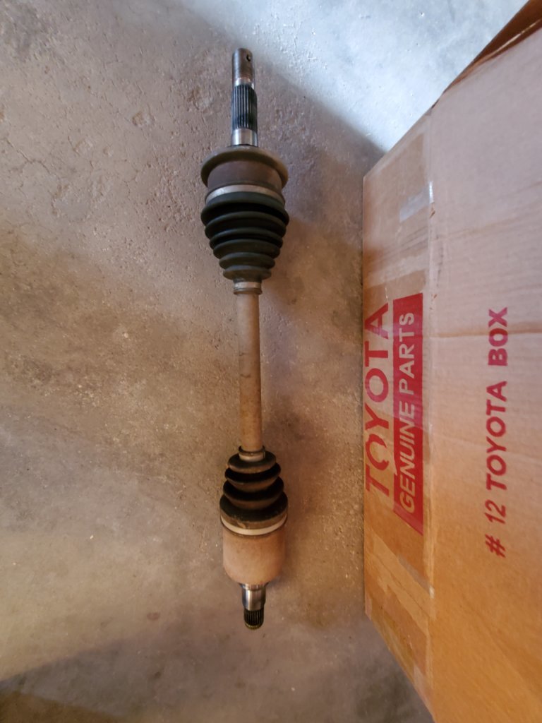

    The NAPA and the Toyota. The NAPA looks great besides some surface rust... Right? This was the better of the two NAPAs that i removed and there were cracks in the boots and a distinct "knock" when I extend it with my hands. The Toyota cv is considerably heavier and much tighter.
    The other CV had a completely torn outer boot and the outer bearing was destroyed.
