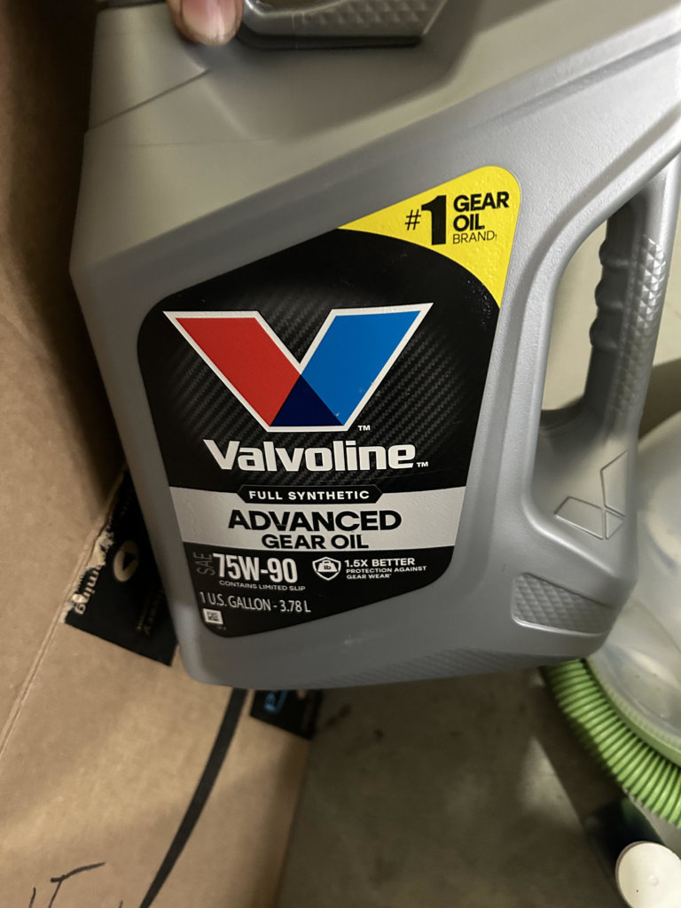

    I see plenty of recommendations for the Rear Differential Fluid (LSD) for Lucas 80w90, which I purchased.
    Upon looking at the Owners Manual, it calls for 75w90 in the Front Differential Fluid and Transfer Case.
    I searched around and didn't really find a recommendation. Anything to suggest for a fluid I could perhaps get a gallon of so I can do the Front Differential and Transfer case? Should I go with the Lucas 75w90 Synthetic? Or there's some Valvoline SynPower VV975 available locally for cheaper.

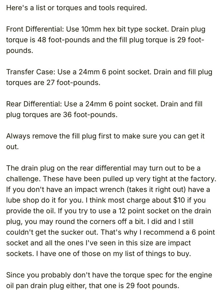

    Make sure you can get that fill and drain plug out.

    Just make sure it says "meets specifications" and not "recommended for". The latter means it does NOT meet specifications.

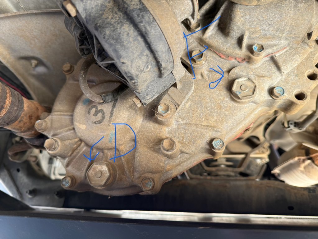

    It wasn't the TC looking back now, its the front diff. My drain bolt 'was' a t55. I could fit in a hex now. The last change was over 150k miles ago so maybe they swapped the bolt too? Not sure.

    Yeah, and replace them with Lexus plugs. Lexus plugs go right in but they don't have the ridiculous 10mm allen that strips out.
    Don't have the PN's right now but a google search will find them easily. Only about $60 for both and the Lexus plugs are external removal. Best of luck to you and 75w is fine.

    I ran into a stuck front drain plug the other day when I was changing all the fluids, never had that happen before. I gave up cause I didn't want to strip it, I sucked out what I could and topped it off. I have a new plug so I guess I'll try and chisel off the old one sometime this week.

    Don't bother with PB blaster. That drain plug isn't coming out, been there tried that. If the fill plug is out just use a cheap transfer pump to suck the old fluid out and pump the new fluid in.
    Messy stinky job in a house garage but it's done quickly. And buy the Lexus fill plug to replace the absolutely ridiculous Yota 10mm Allen plug. Have a good day and donate to charity.
