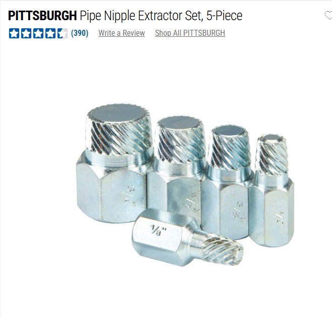

    As suggested, heat, tighten it (it won’t spin, but helps break free), tap the hex key socket in with a mallet to make sure it’s seated.. and they sell this at most Autozones now:
    It will break free eventually. You will think you broke your ratchet when it does.

    This is one of those products that probably 9/10 of us invented in our heads years ago but never capitalized on :( Canned air too. We could have been rich and retired. I never knew the stuff existed!

    Right?! I used to chuck a bolt or piece of round rod in the freezer over night, then heat up the offending bolt or nut and quickly touch the frozen bolt to it afterwards. The can is much more convenient...
