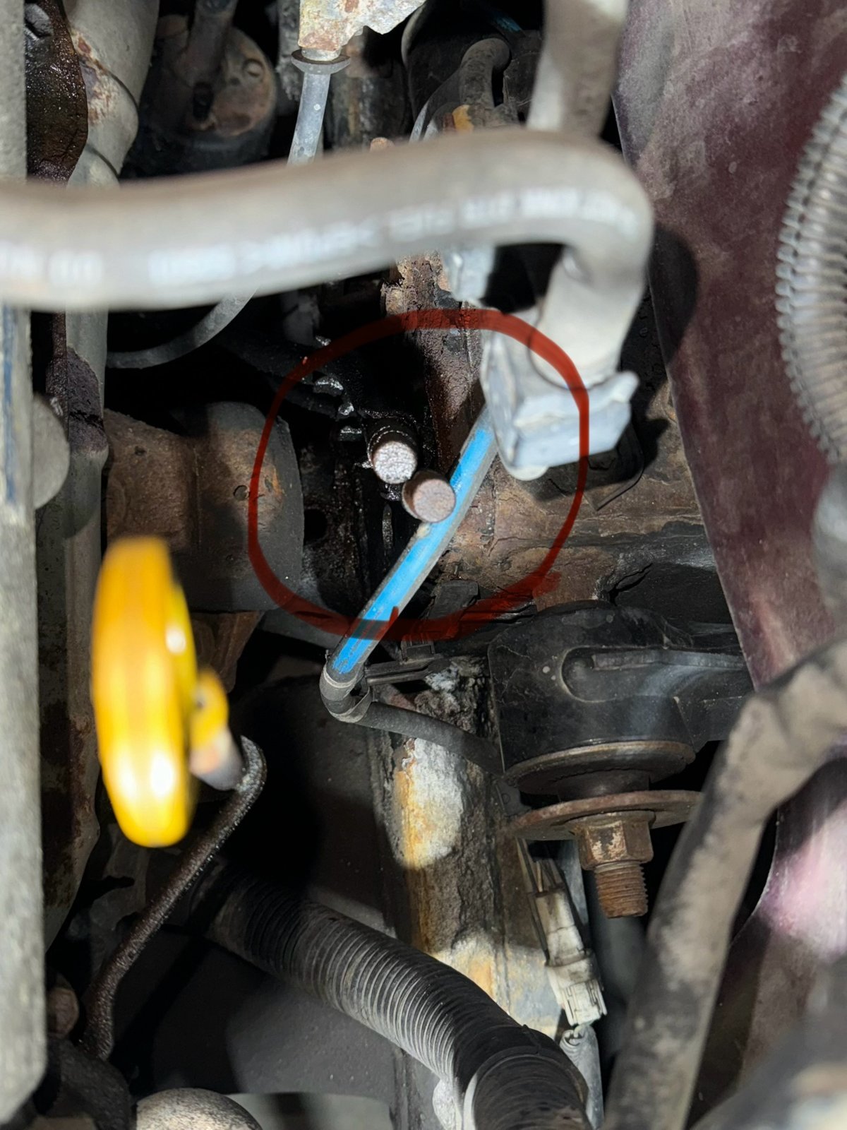

    Hey guys I was doing an oil change today and noticed some fluid on the frame and axle on the driver side and it looks to be coming from what I think are breathers ill attach a photo they are circled in red. Has anyone had this issue before why would Diff fluid be coming out of the breathers? I did touch the fluid and smell it and it definitely smells like diff fluid. Thanks

    Are your axle seals leaking at the diff too?

    no I checked the seals axles on both sides they are clean and dry

    After looking at the picture I went to check and its not a hole in the frame lol just weird lighting in the picture I guess

    Had been researching diff breather and oil seal leak issues (potentially related to breather plugging that doesn't sound like your problem if the breathers are leaking). But others talk about your issue happening for various issues such as cold each winter (likely increasing oil thickness so it doesn't drain back down the tube?), overfilling, and driving inclines. Did you change the front diff oil recently or drive steep terrain or is it really cold where you are now? Looks like it might be in single digits for you?

    Did you submerge it in water? If there is water in the diff oil will float to the top. May want to change your oil and be sure to fill correct amount

    Yeah I started researching more seems like a lot of people start having the issue when its cold and it has been below freezing here pretty often in the mornings

    I think they all leak. I've had tacomas and tundras and they seeped on both, but no seal leaks. My 2001 tundra looks like the pictures you have attached and I haven't had any issues.
