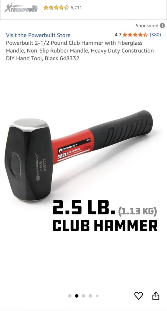

    I couldn’t get mine off once even using my feet on a breaker bar. Put my tail between my legs, and took it down to the Dealership. Tech called me back once up on lift to show me what they do to loosen it. Took a club hammer (small flat faced sledge hammer), and pounded it square on the plug a few times (hard). Came right out.

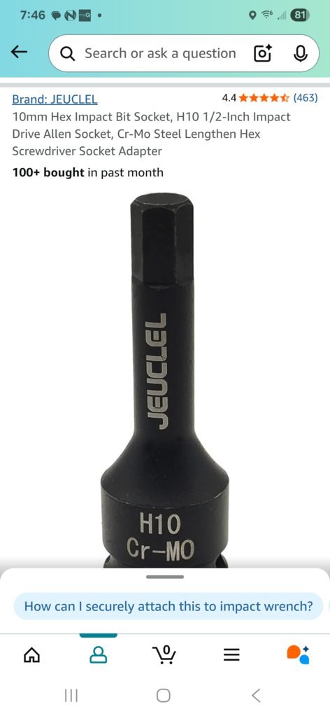

    After this thread surfaced I decided to hit all my drain and fill plugs with PB Blaster a couple of weeks ago. Today I hit the front differential again and tried loosing ... like butter with 1/2" ratchet. Something to try before fluid change.
    I used this

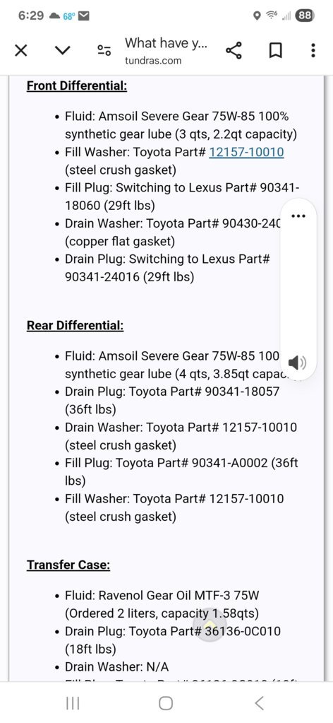

    Lexus plugs are the way to go

    Try Partsouq.com for the Lexus plugs

    I got mine from Ebay..Lexus 90341-24016 plug & 90430-24003 gasket-crush washer..combo for front diff drain plug
