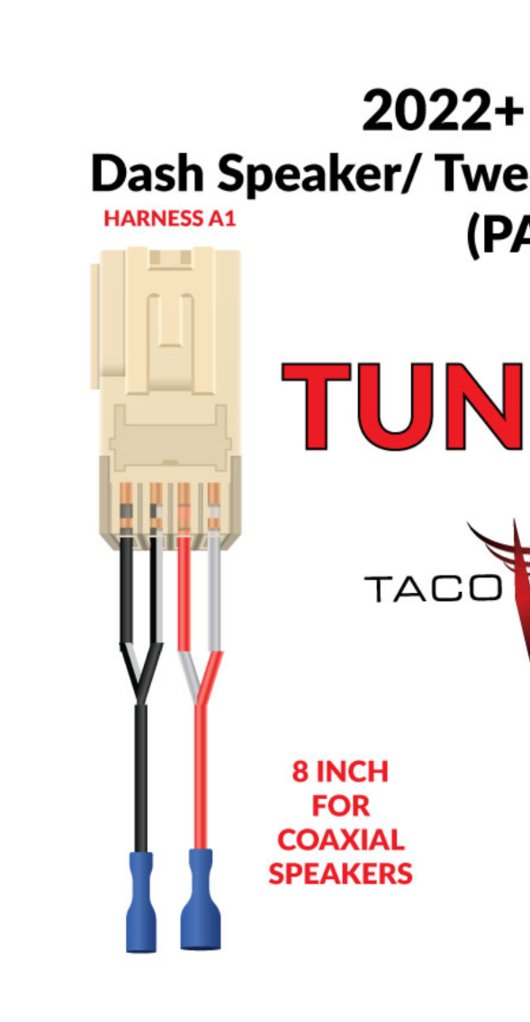

    the problem is that when I raise the volume to 30+ the driver dash speaker will pop and get distorted, I tried switching the speakers around to check the speaker but they all do it when connected to the driver side dash. Does anyone have an explanation for this or an idea on how to fix it.
    I’m new to Audio, well at least since high school when I installed an amp and sub in my truck but that was a while ago.
    to install the speakers I used ********* dash speaker harness
