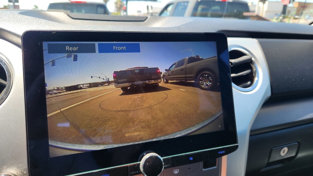

    I imagine your Kenwood is probably like mine and has multiple camera inputs.
    So shifting into reverse brings up the BU cam, and there's a "Cam" button on the HU (as well as a "press n' hold" Maestro steering wheel button) that brings up the cams, and I can then toggle between front or anytime rear.
    That means there's multiple switches... maybe some of yours aren't playing nice together?
    I love the front cam... I'm usually pretty good at knowing where my wheels and bumpers are, but even 2 years in I really have no idea where the front of this beautiful pig is!

    Make sure your camera has a power source, so if it’s on a switch right now that will need to be on. For my front camera I just tapped the 12V wires to the head unit from the main vehicle harness that are powered once the key is in the “accessory” position.
    Check the back of the Kenwood for your camera inputs, should be several and one should be labeled “front” or something similar. Plug the video output from the camera into that pig tail.
    You select the camera view by hitting the “CAM” button on the Kenwood and then you can switch between any of the cameras you have with the touch screen.

    Ok I got the front camera working. I ended up just hooking it to the Kenwood. All I needed was power. Now to figure out the maestro press and hold setting..........
