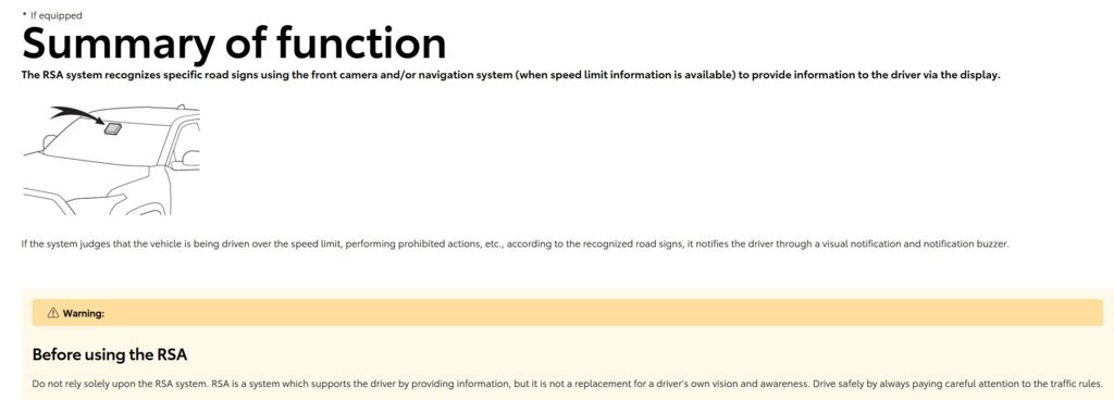

    From the manual (about the RSA function) it's quite clear which camera is responsible for this:

    Thanks, but my question is specifically about which camera controls the radar cruise and front collision detection systems, not the RSA system.

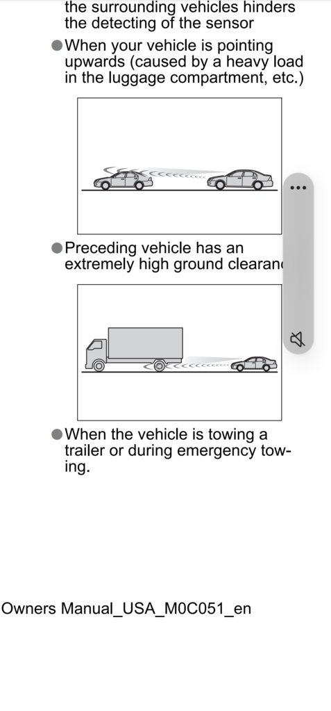

    I'm pretty sure is uses both the upper camera and of course the radar in the grill. I found this in the manual in a section about when radar cruise wont work.
    ●When there is rain, snow, etc.,
    on the front surface of the radar
    or front camera
    Also, these pictures in the same section seem to indicate that as well.
  30. Dec 5, 2024 at 10:22 AM
    #30
    Matt2015Tundra
    Matt2015Tundra [OP] New Member
    Aug 9, 2022
    #81755
    1,593
    2023 1794 CrewMax
    Thanks, DRP. That clears up my confusion.
