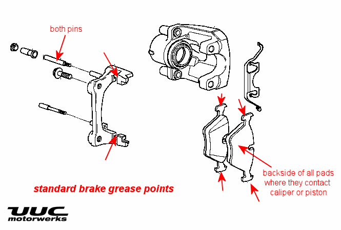

    Did you grease the slide pins and the slides between the caliper and brake pad ears?

    So I have always properly greased them, the first set was nappa, the 2nd one was some after market from oreillys. I always flush and bleed. I have changed the bent line going strait to the caliper and the rubber line going up past that but no lines to the booster or master cylinder. Thanks for all the input I just changed all calipers rotors and pads, and I will now change the lines leading up until them at the least
