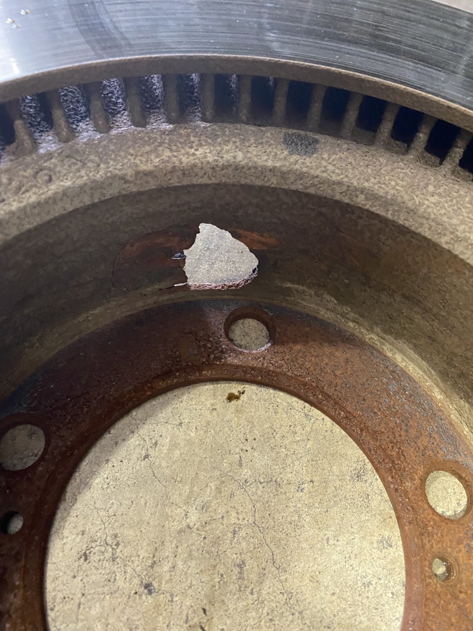

    This was my issue. Lift shop forgot to torque the bolts properly and came out and broke through my rotor

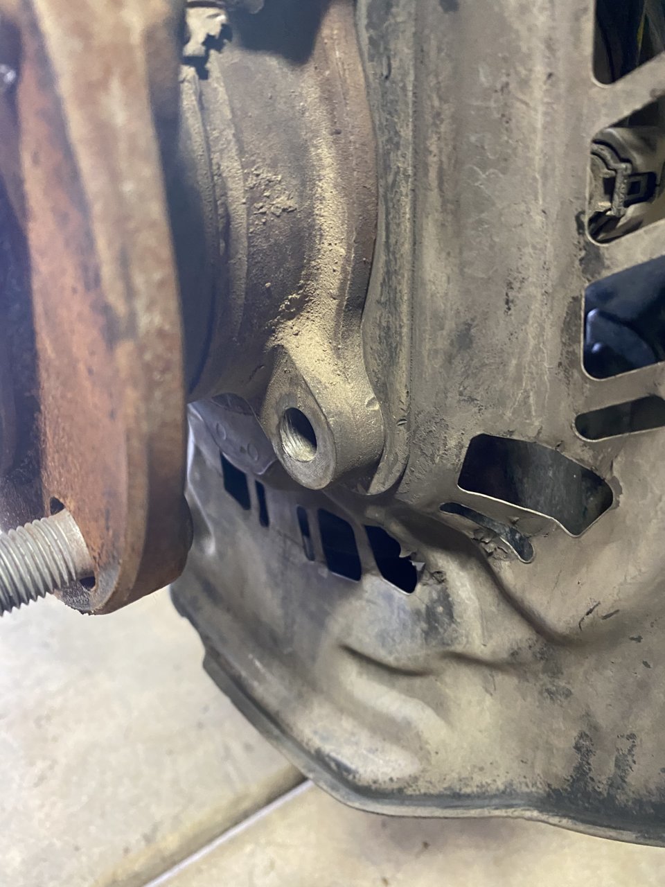

    Turned out to be the skid plate, I noticed there was a missing spacer for one of the bolts. Could be part of the problem.
