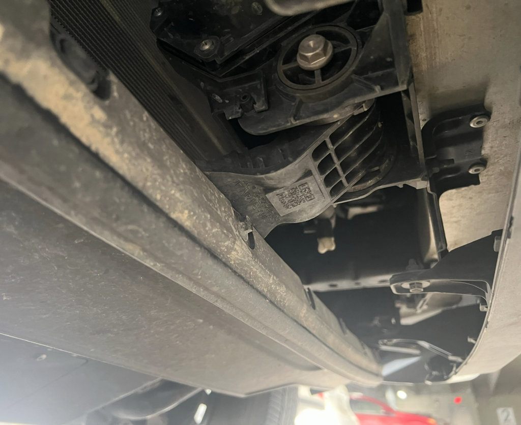

    Time to call the dealer and schedule some time.
    One more unnecessary over engineered item to fail.... and it did!

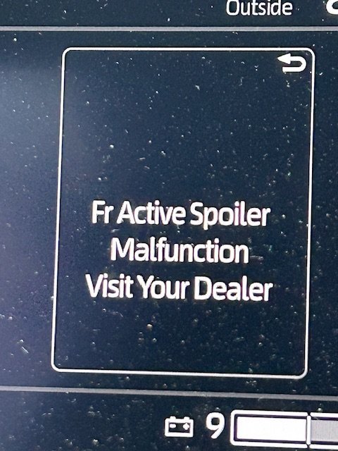

    Fr Active Spoiler Malfunction Visit Your Dealer.
    Sure you can make it go away, pops up again complaining every few minutes.
    It started intermittently and now its constant.
    Sort of hanging now... doesn't go up or down. (Front spoiler, not me!)
    Well I guess that after searching a bit this doesn't seem to be too common of a problem.
    Just lucky I guess.
    Anyone else have this device fail? If so I am curious about the time it would be needed to be fixed.
    Love to bypass the device and did find a company that makes such a gizmo. Not really sure I want to pay 100+ just to not see a message anymore.

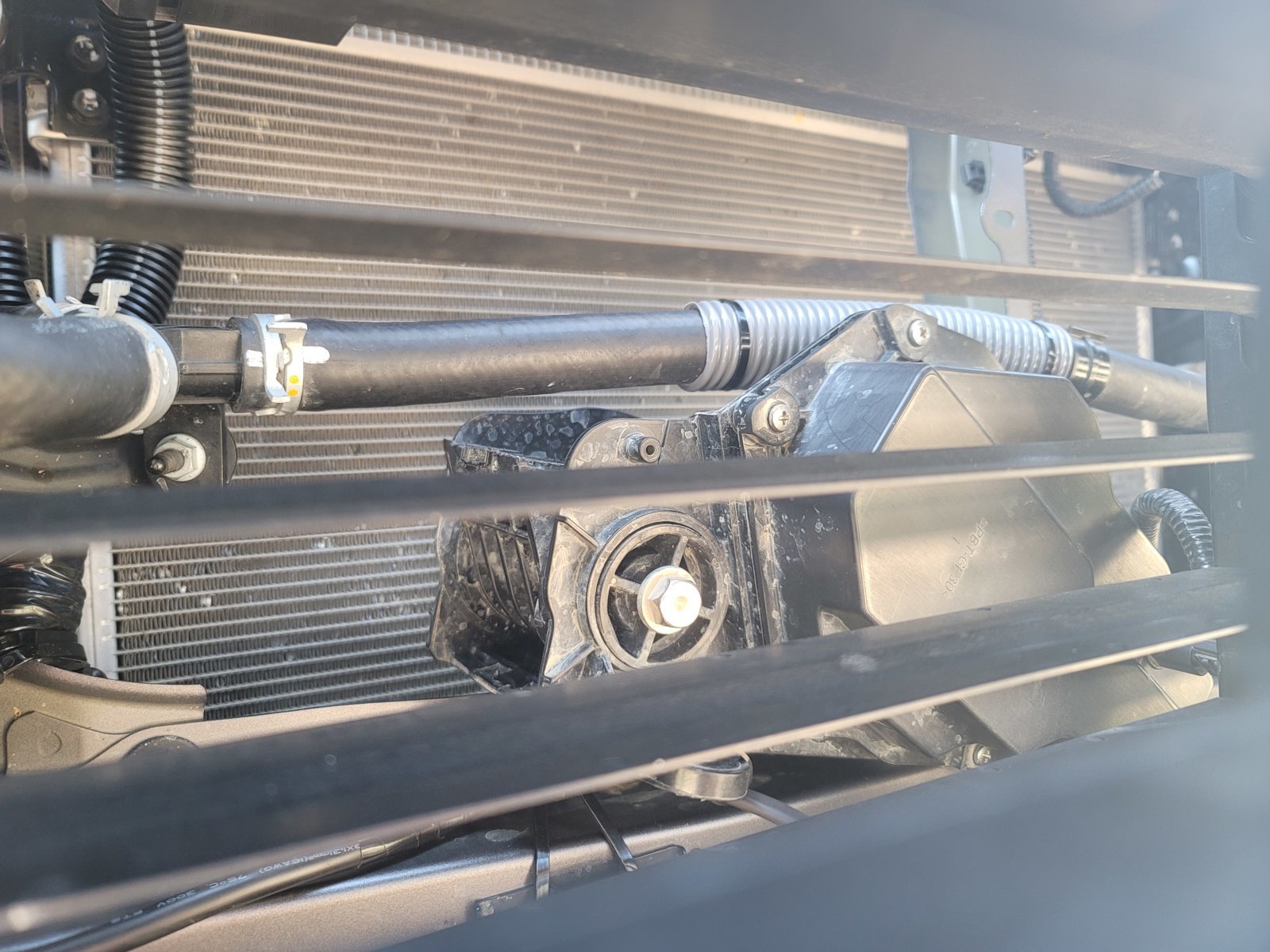

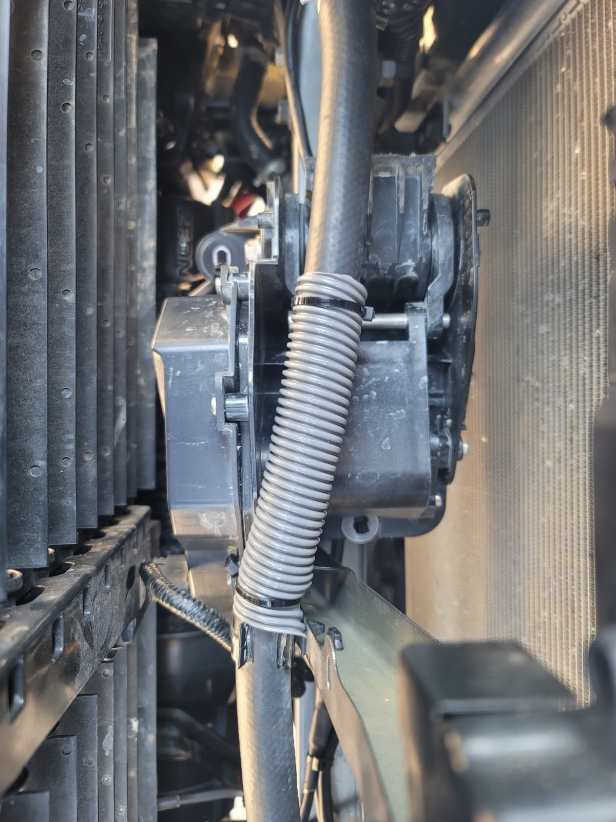

    20240807_112903.jpg 20240807_112822.jpg FIXED! No more error messages. With the hidden winch bumper installed, there was no room for the whole motor. The dealer cannot permanently flash the error message out.
    The fix:
    I had to cut the motor housing mounts off with my Oscillating Multi-Tool. (NOT anything that penetrates the housing with the motor and gears inside.). I also had to cut off the Flap that bolted to the actual valance. (the flap that moves up and down). I zip-tied the motor on the x-bar that runs in front of the truck behind the grill.
    Hope this helps!

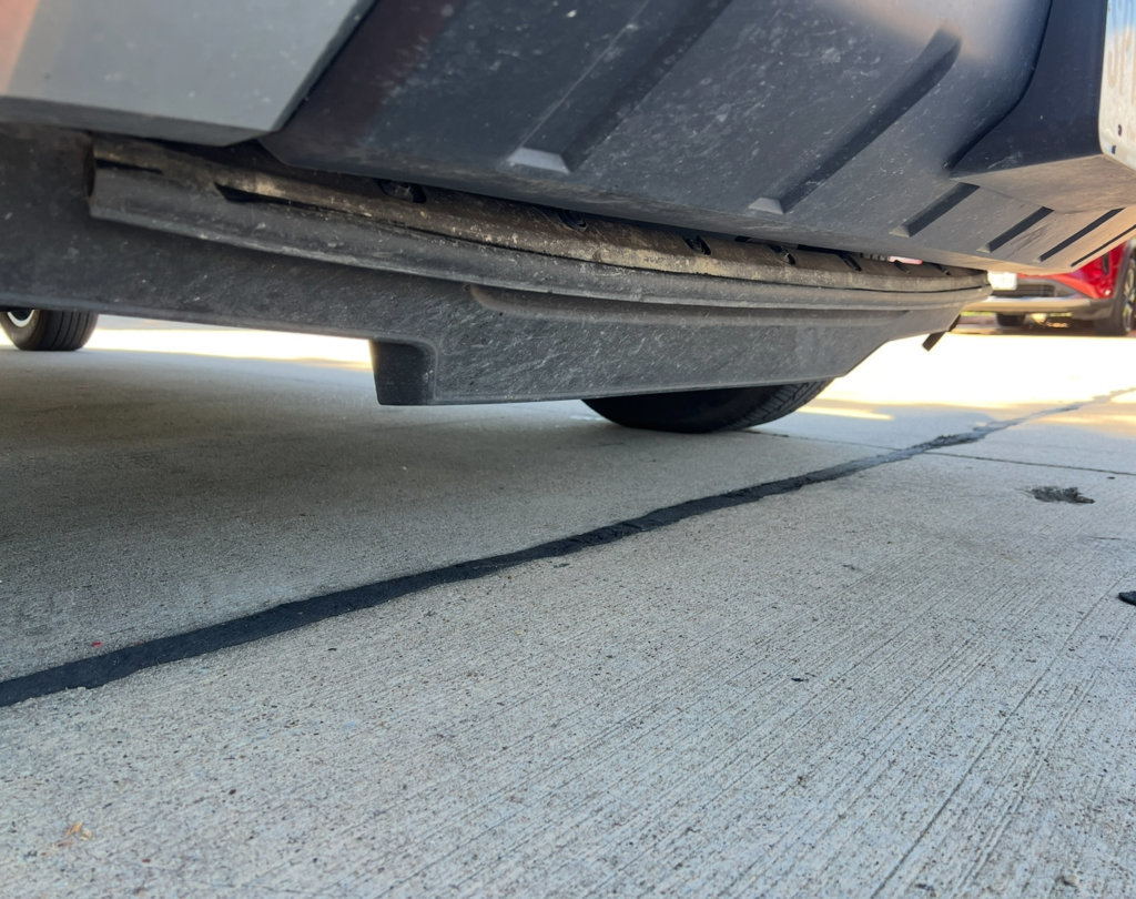

    This happened to me last week at 42k miles and I was genuinely surprised it held up that long. I was doing 80 mph and didn’t see half a tire on the road until it was too late and there was no where to exit (I’m a little smooth brained in the mornings) but the hit didn’t feel bad and there was no physical damage to the drivetrain and fuel tank just some marks on skid plates.
    There were no errors for the rest of the drive but after being parked for 9 hrs and going for a drive the truck start showing me the active spoiler malfunction error every 5 secs. I looked up the price for the motor assembly and rip.
    I started looking up @testerdahl videos interviewing engineers and attending the rolling chassis event because I remember seeing this part mentioned and how the failure mode was designed. Thanks Tim you saved me some good chunk of change and I’ll try my best to help others in the same boat as me.
    You can fix this problem pretty easily. No tools required, and essentially you just need to realign an internal position sensor that confirms the position of the spoiler. During a hit the internal clutch slips and absorbs the shock (beautiful).
    To realign the spoiler limits turn off the engine pull up on the mist lever and wait for the spoiler to deploy (It wont fully deploy because the clutch slipped and the motor can’t turn past a limit switch) pull on the spoiler to position to the fully deployed position. This shouldn’t take a lot of force, but once the spoiler is deployed the force it’s takes to push it back is much greater so you could use this to judge if the spoiler is fully deployed. Now start the engine and go for a drive and if your spoiler is working then you are done.
    If your spoiler isn’t fully retracting as shown below then you simply have to follow the steps below and push it back up to its retracted position.
    Start by turning off the engine and disconnecting the motor assembly’s 4 pin connector after this push up on the spoiler.
    Reconnect the connector. Go for a drive and your spoiler should be adjusted to its original position and the position sensor is happy. Hope this helps someone from an expensive bill.
