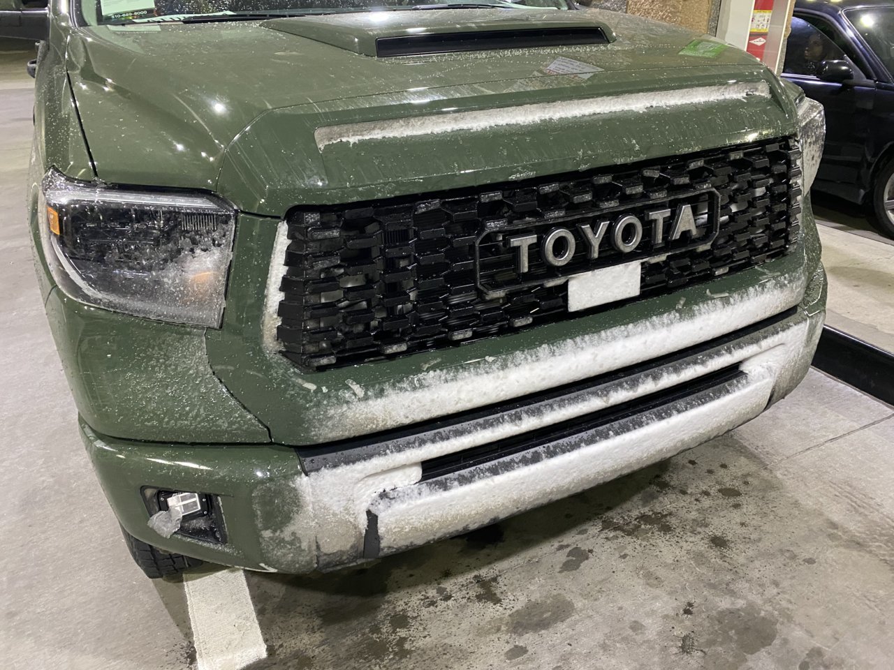

    After seeing how little snow it takes for the TSS radar to be rendered useless I’m considering removing it altogether...

    Pretty sure it's a known thing that it won't function in bad weather. Might even be in the manual. Heavy rain can mess with it. In those types of conditions they recommend no cruise control anyway, so you aren't losing anything there, but the crash avoidance is blind so it just shuts down.

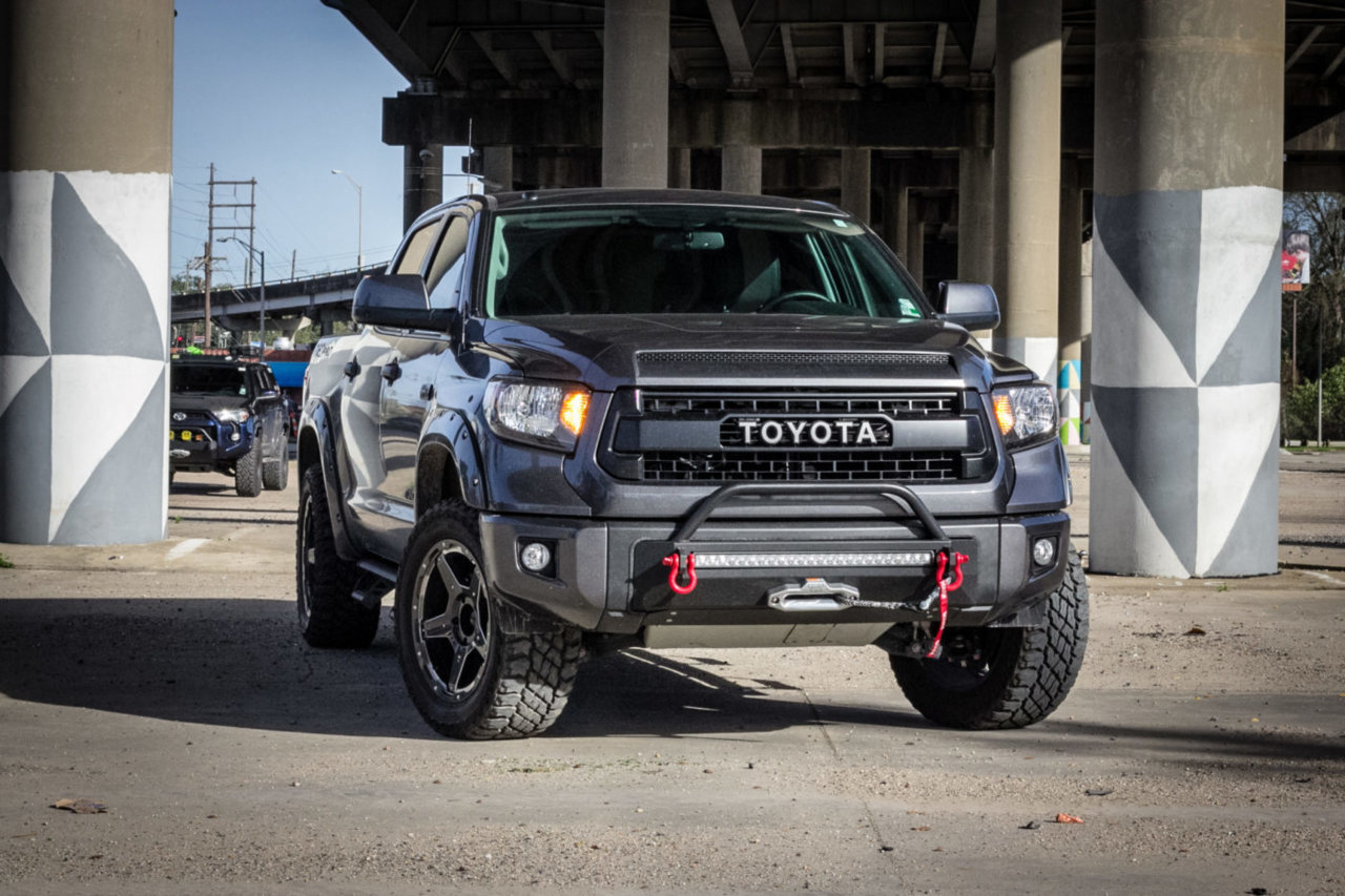

    I’ve got a SSO Slimline front bumper with the bull bar and am having it installed on my 2020 SR5 with a TRD Pro grill next Monday. I will report back on any conflict with the TSS front features and photos once I get it installed.

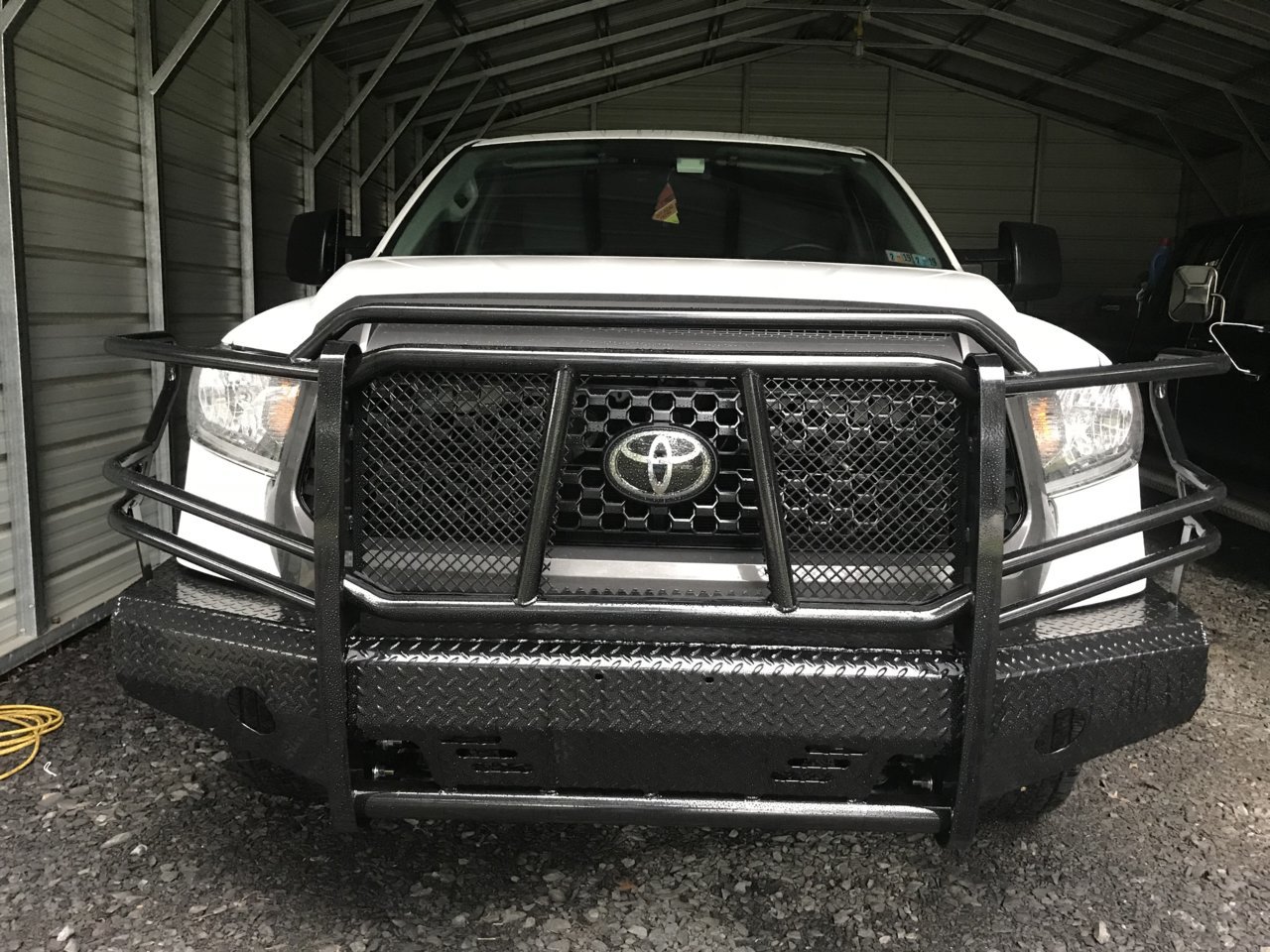

    I put this on in Oct 2018 and haven’t had any issues from the bumper other then the normal snow, rain , heavy fog.
    Btw, if you go with the hoop bumper “bull bar” they cause more damage then protection when it they are impacted.

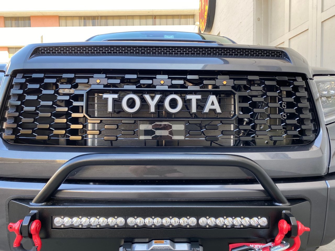

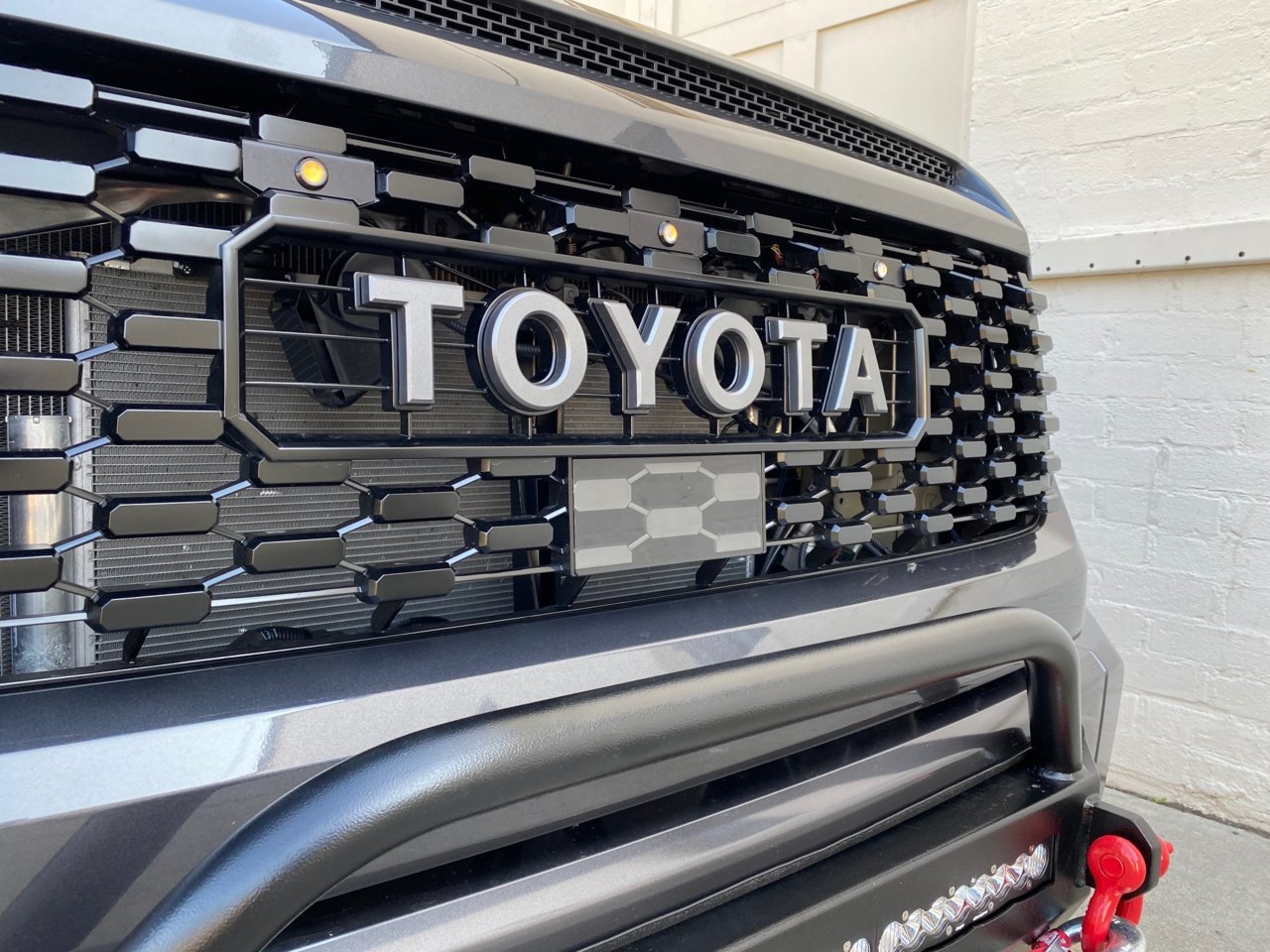

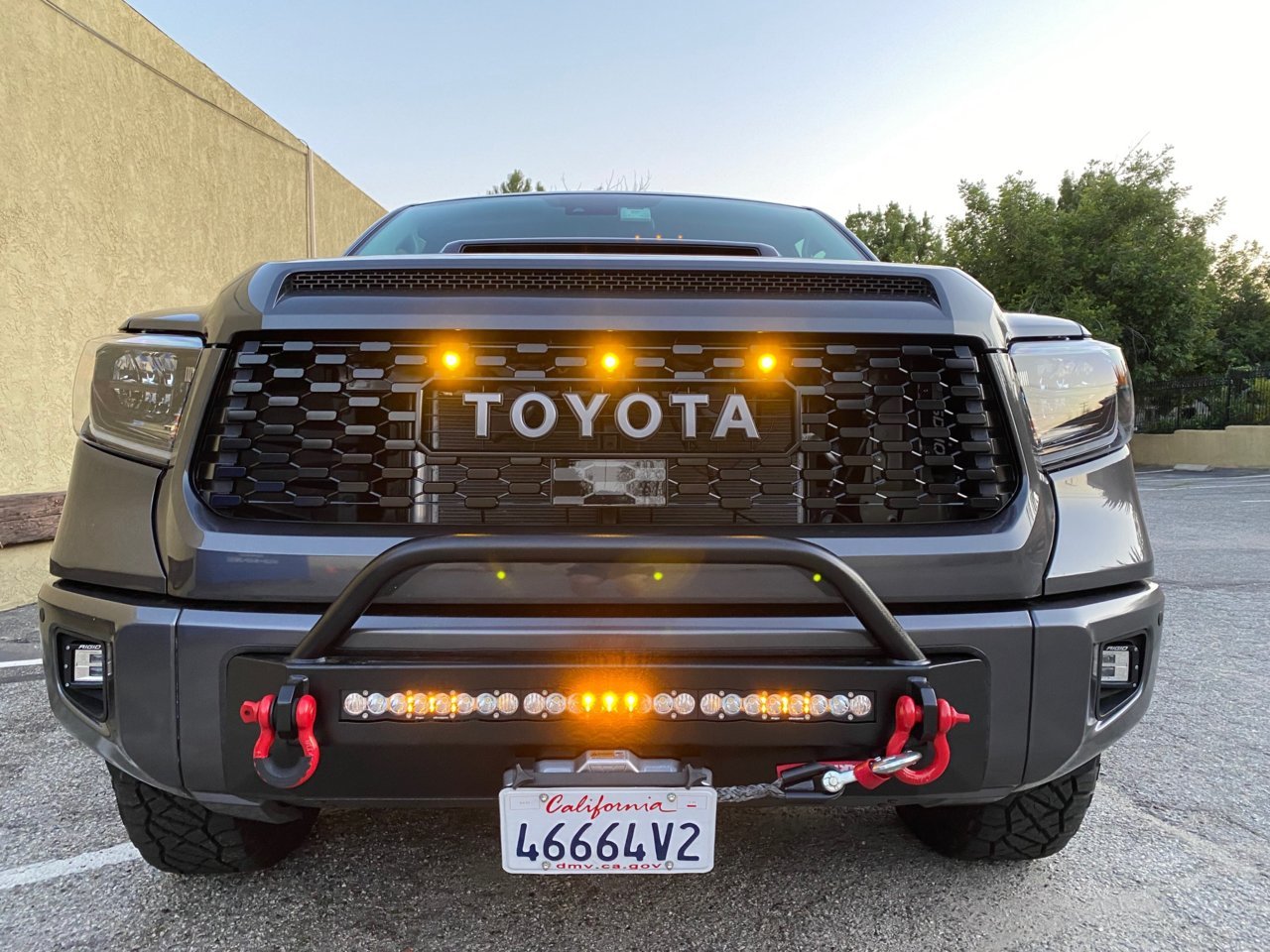

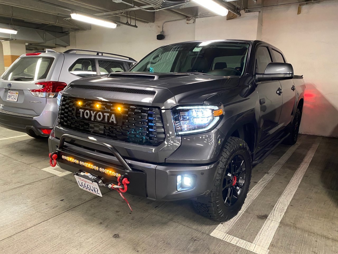

    I got the truck back today and am happy to report that there are no issues with the SSO Slimline Hybrid Bumper w/bull bar and TSS. The bull bar sits below the TSS sensor on the TRD Pro grille. The sensors on the non-TRD Pro grille sits even higher.

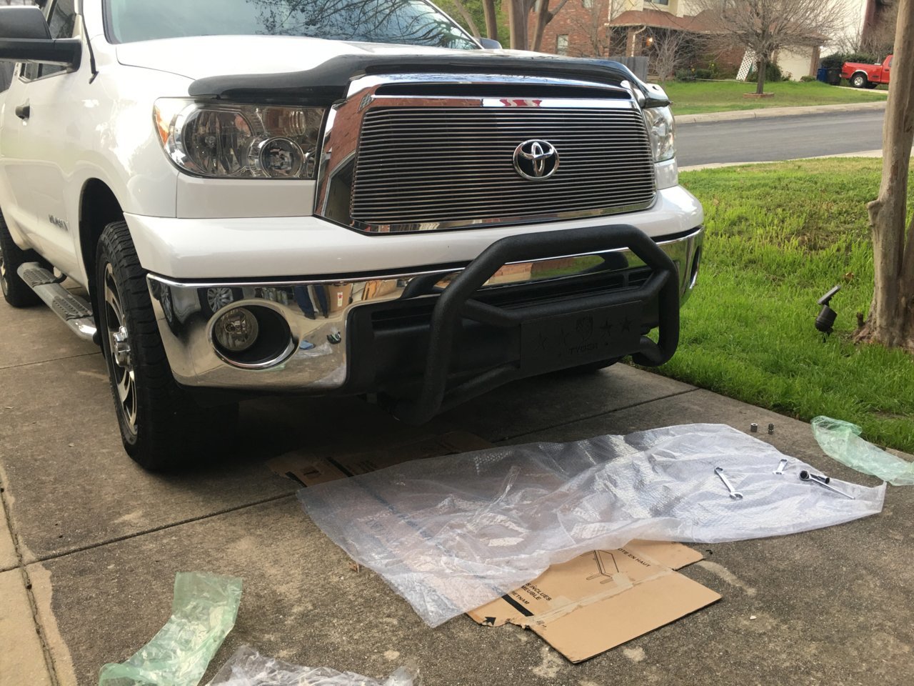

    Looks pretty awesome! I just installed a Tyger bull bar that the wifey got for me for Valentine’s Day on my 2013 tundra. I guess Valentine’s Day can be pretty good for guys after all lol
