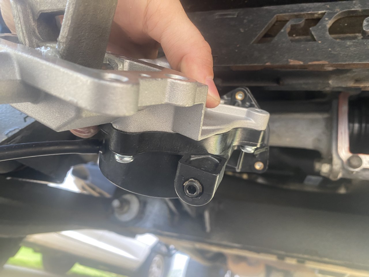

    2011 Rock Warrior Tundra
    4in Rough country Suspension lift. Camper top. Bull bar with Led lights.
    hey guys
