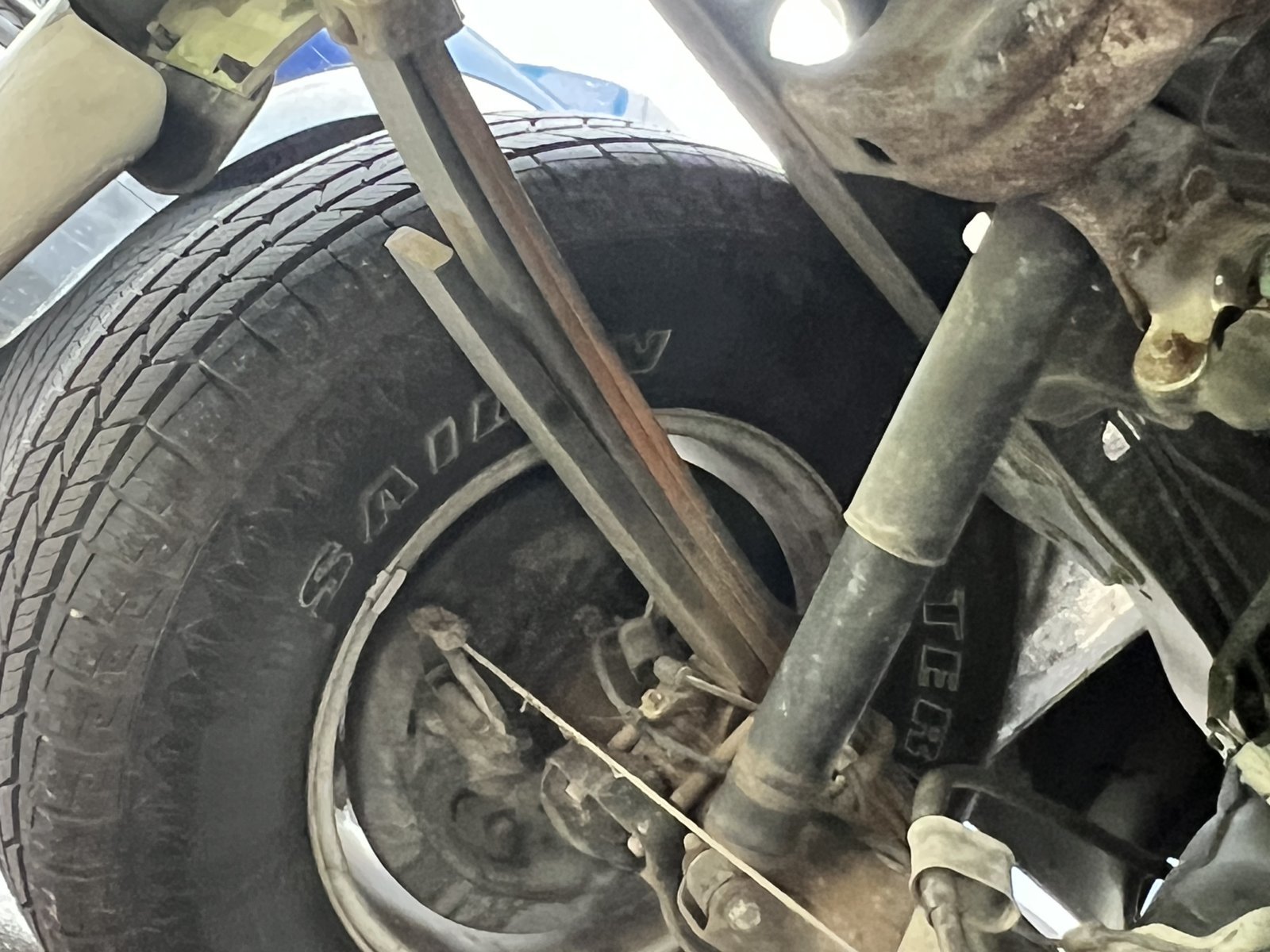

    I just noticed some frame rust on my tundra. It looks surface level. What can I do to get rid of it/prevent

    Nov 2, 2020

    Based on those pics I don't see anything massively disturbing, the tow hitch assembly is notorious for rusting out even on southern trucks, and that's a huge swath of what's showing in the 1st pic.
    But either way, you've got a 2005. Even if you had enough rust to warrant a frame recall, your year isn't covered.

    Yea the tow hitch is covered in rust, so what is the best COA to remove and protect against rust on these tundras? The truck is from Louisiana

    I mean, If you're not driving on salted roads, and not dunking the ass-end into water on a regular basis, simply descaling off the rust you're showing and re-hitting it with matte or satin frame paint (Seriously, I've been in the south my whole life and Rustoleum outdoor satin black is all I've ever used!) is perfectly fine. That's just my 2¢. You can go overboard here, and POR-15/SilverBullet/Eastwood Encapsulate your frame, then woolwax it every other year, but I don't see any reason to for guys like us living in SC/GA/AL etc.

    I think some satin black rust oleum is the way to go. Thank you much

    Make sure you at least knock the flakes of rust free first. The big thing you want to keep eyes out for is delamination, like ... you know how good fancy biscuits will peel apart in layers? Watch out for that. Or how some rock will chip off in flat chunks? Watch out for that. All I'm seeing in those pics is flaky rust, but purely superficial. I mean, I'd like better pics of what it looks like when you take a brush to it, and I think others would too, it'd give us a better idea. But seeing how much nicer the "typically bad" spots are, and how good the framerails look, I legitimately think that's superficial.

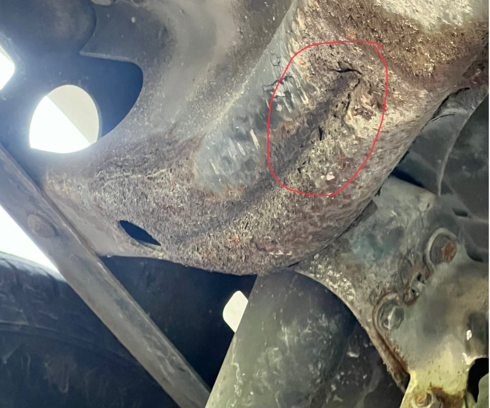

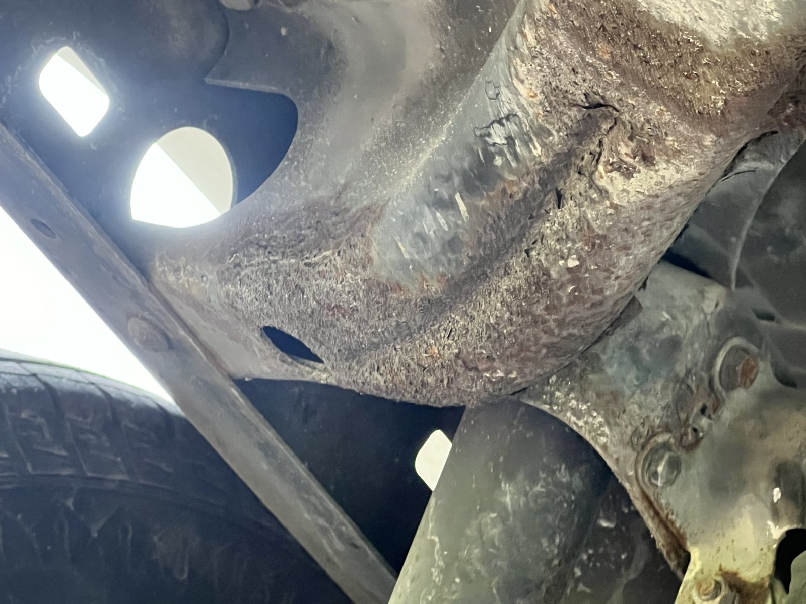

    Is this perforation?

    If it goes through I'd say so. If you were to tap it would it create a hole?
    Can you see through any of those what appear to be pin holes?

    Won't know until you wire brush it.

    Looks like flaking paint to me.

    I painted a trailer with that years ago and it rusted like crazy. Whatever they put in it for a "matte" finish seems to let road salt penetrate easier. I would just pressure wash it, let it dry a week and spray it with fluid film.

    That’s flaking rust. The shadows make it look like there’s holes.

    X2 on the Fluid Film. I also like Surface Shield, which seems more durable in my experience. Fluid film is more likely to wash off, so I think it's better for more protected areas like door cavities and inside rocker panels.
