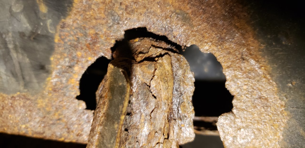

    I have some serious rust issues with my 2006 tundra with 156000 miles. One of the brackets for the swaybar is rusted out bad. I took the truck to a frame and axle shop. They quoted me $1300 to repair the frame. This would include fixing all rusted frame components. Not just the swaybar mount. They honestly said that they can't guarantee what the final cost will be until they get into doing the job. I'm really not sure if It's a smart move to try to get it fixed. So far it's been a great truck but I'm worried about how safe it is to drive. Just wondering if any of you 1st gen guys have had they're frames repaired. I do know a guy at work who took his 4runner to this same repair shop and they were able to fix his broken frame.

    Too bad because the truck still looks good outside. The guy at the shop said " toyota can't build a truck frame to save their life!"

    Is this truck eligible for the Toyota frame recall? If so, new frame, free.

    Depends where it's rusted.
    Check out autorust.com
    https://www.autorust.com/product-category/toyota/tundra-2000-2006/
    BTW, the bad frames were made in the US by Dana Corp, who also makes all the notoriously rusty Jeep frames.

    It has. I'd take a hammer to the rest of the frame. If that's the only soft area I'd be surprised.

    I've contemplated it at $2K quote, but that's just grinding it down and welding a thicker plate to the bottom of each boxed in frame rail. I'd like to learn how to weld and do it myself though because I'd know it was done right instead of just adding additional metal that will only take x time to rust through again.

    Yeah, but they really don't take care of the existing rust so much as grinding it ALL off before applying the new metal. They just cut out the worst part and tack on the new metal so you already have starter rust to work on corroding the new metal.

    That's going to be expensive and no guarantee it would last any longer, since welding weakens metal and greatly accelerates rust. Especially when done right on vehicle and no proper anti-rust treatment applied, because of tight corners, etc.
    Instead, I'd look for a replacement frame from junk yard, and let the shop work with that frame, leave no rust trace, treat everything thereafter. Even if the rest of the vehicle is in great condition for its age, the "new" frame will probably outlast it.
