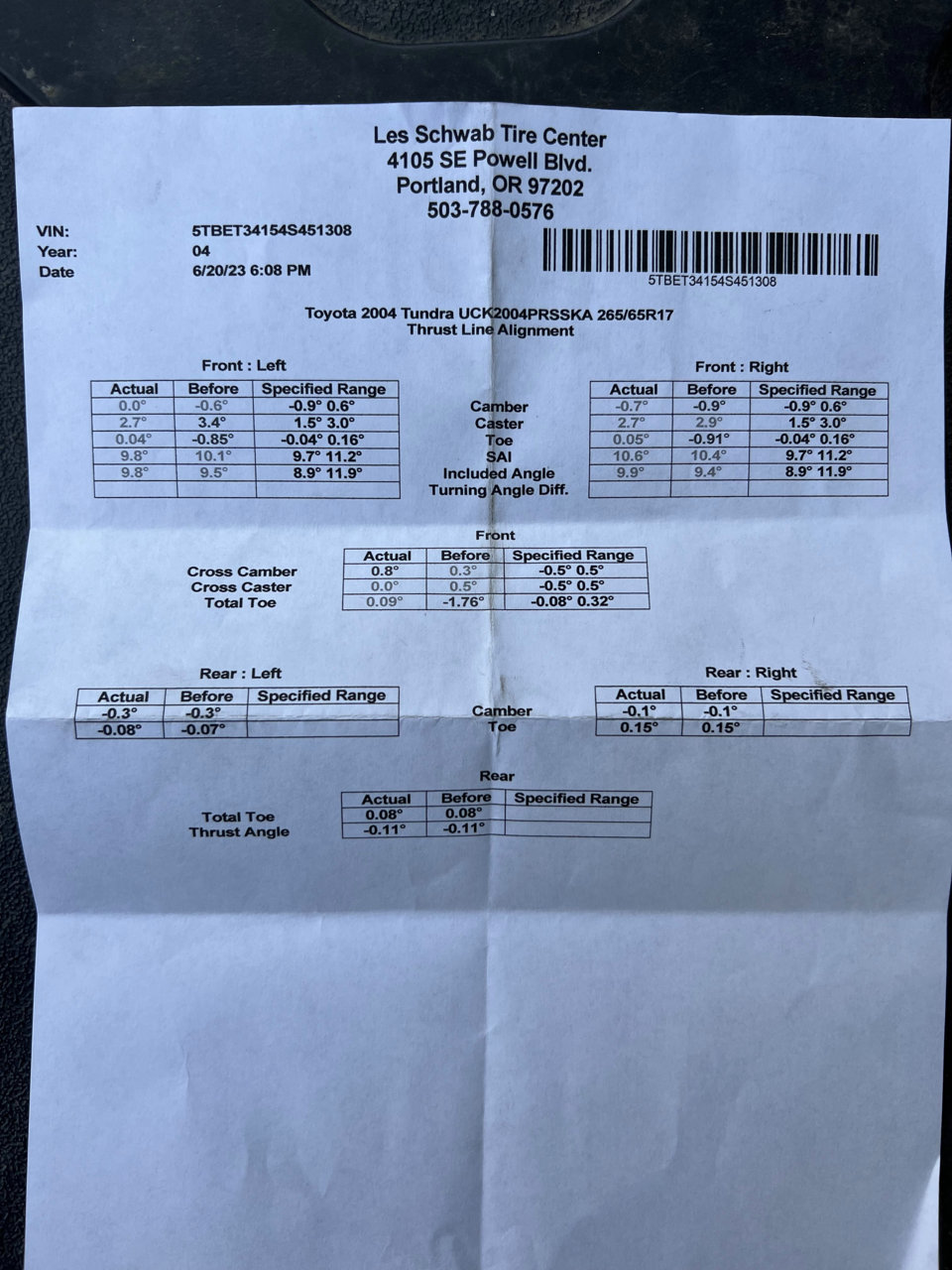

    Just had it aligned at Les Schwab, and now I have front frame rub on both sides in full crank. How could this new and lifted setup, with the same tires as before, now have frame rub for the first time? My only guess is an alignment/camber issue? They did not touch the camber adjustment on the SPC upper control arm. Is the issue potentially that I had that pushed inward too far (it's about half way) going into the shop and they adjusted the bottom off of that? Could I gain more clearance by pulling this adjustment outward and then having it realigned?
    Thanks for any input. Below are my alignment results.

    Probably because the guys who aligned it have no fucking clue how the SPC arms work, that they're slotted, and the balljoint is clocked and needs to remain in position. Exactly what I'd expect from a chain store.
    Before you do anything, confirm the balljoint is still clocked in position "D" per the instruction sheet.

    @shifty` balljoint is in the D position with the SPC logo facing out. The slotted camber adjustment was set roughly in the middle before alignment. Yesterday, I moved those slotted adjustments outward about 2/3 the distance on the slot, and took it back in for a warrantied alignment. Just got it back this morning, still having the same issue.

    @evanhmn good to know. The results are reading that all of my alignments are within range. Maybe time to bring it to a 4wd/truck specific alignment shop...

    Anyways. Looks like they just didn't use the uppers. Or don't know how to setup for larger than stock tires for clearance and work back to even'ish numbers from there.
    Caster looks good, they just needed to bring the camber in on the LF.
