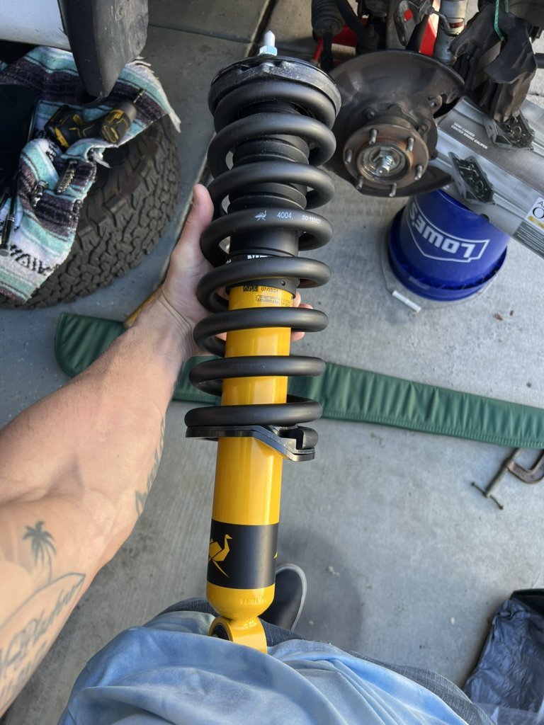

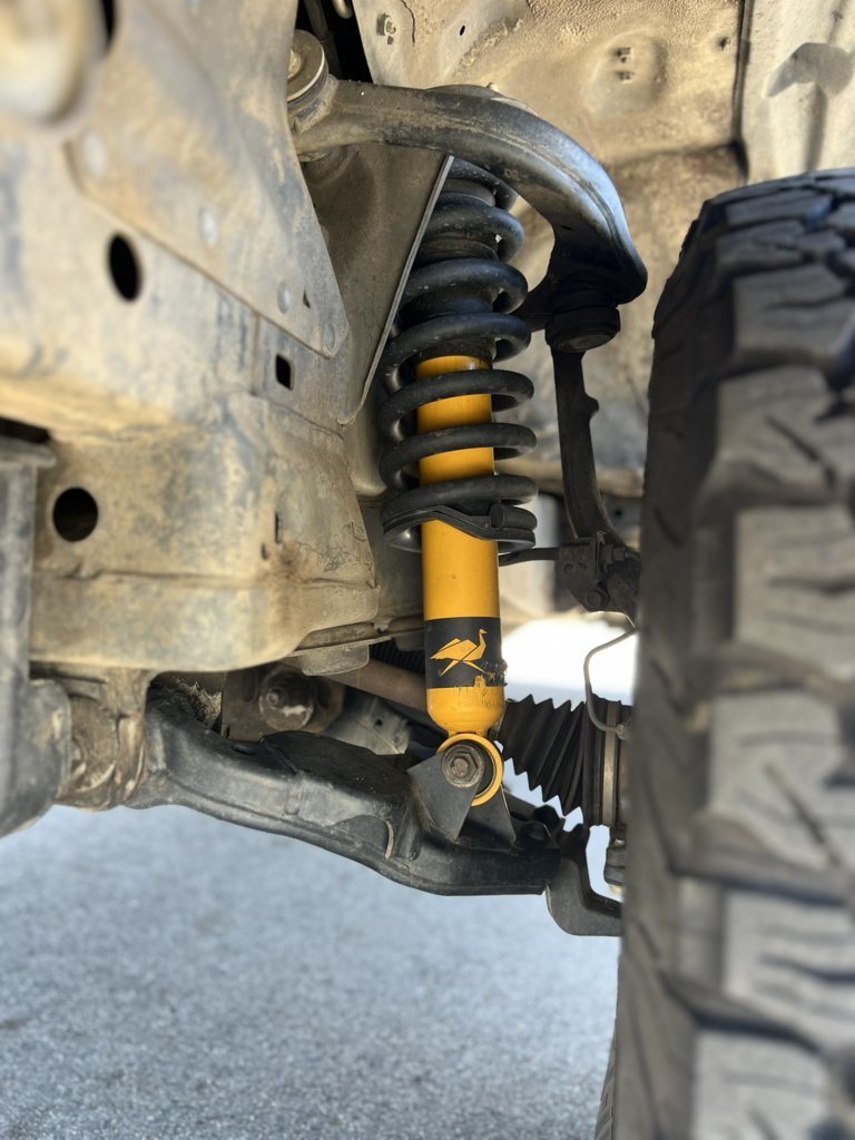

  19. Mar 20, 2025 at 4:52 PM
    Anima
    Anima New Member
    Jan 24, 2025
    #129323
    30
    2000 TRD Tundra V8 4x4
    Did you ever get this issue figured out? I'm having the same issue with some OME Coilovers. I have Old Man Emu 93004 Front shocks and Old Man Emu 4004 Front coils. When I go over a speed bump the compression feels nice and smooth, but the rebound is awful and slams down hard. My 04 Corolla takes a bump smoother than my truck and it's pissing me off! The coils give me 2.5 in the front. I'm thinking about getting new coils or going with a Bilstein at 1.75. Any thoughts or advice on how to adjust my current coils would be great. Otherwise I'm probably just gonna take these off. Thanks!
    Here's a photo of the coils. They look great, but the slamming has got to go.
