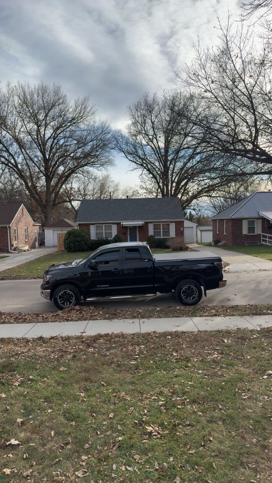

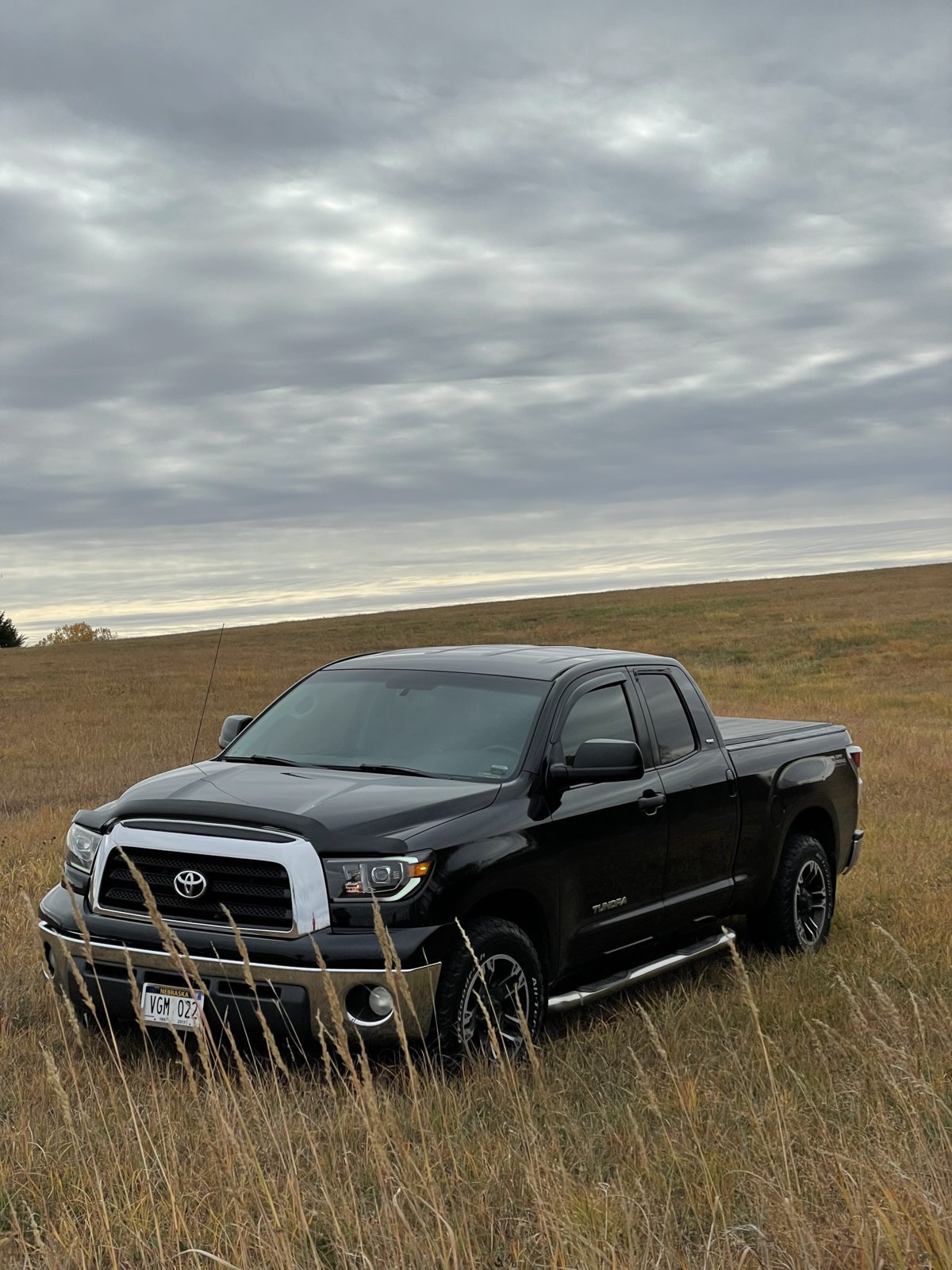

    *PICTUREs OF HOW IT SITS NOW BELLOW*
    I currently drive a 2007 Toyota Tundra double cab SR5 with 4 wheel drive and I'm looking to upgrade the suspension I have currently. The truck currently has 267k miles, the original OEM shocks were replaced at around 200k miles with Monroe replacements (which I really haven't liked since the day I got them but didn't feel like spending the extra money replacing them since they were still functional). It still is using the oem springs and the shocks I believe have been blown for a while now and I'm finally getting around to replacing them. I also am still using the OEM upper and lower control arms which I also plan on replacing at the same time since the ball joints have been making noise for a while now.
    Two shocks that I feel I like the most are the Fox 2.5s and the King 2.5s.
    My reason for this post is to hopefully get a little guidance or advice from those who have had or currently have setups like mine to help determine what best matches me.
    Here's my goals with my suspension and what I like/dislike with what I have currently and what other brands have to offer:
    1. I'd like to keep somewhat of a rake going because I use the truck for work and I do like the way it looks currently. I'm occasionally going to be towing, but nothing too crazy heavy since this truck is now the "retired tow vehicle" because of the high mileage. Maximum weight would consist of a single axle trailer with snowmobiles in the winter or a dual jetski trailer in the summer. If plans do change, I'd be more interested in spending the money on airbags vs an add a leaf in the rear.
    2. I'd like to do a "minimal lift" upgrade keeping it between 0"-2" of lift in the front (hopefully to maintain the rake). Will either adjust the coil-overs to remove the "tundra lean" or add shims if needed.
    3. I don't have any extra weight added and don't really plan on adding any major heavy upgrades in the future. If I do, it most likely will only be additional lighting, and maybe skid plates or a low-profile front bumper but most likely won't so I feel the springs that come with whatever coil-over I chose will be sufficient.
    4. I don't do any hardcore off-roading or trails because of the area in which I live, and it mostly would only consist of occasional gravel roads and deep snow whenever we get some in the midwestern Nebraska area. The main reason I believe I'd like the progressive and "softer" fox/king 2.5s over the digressive and "stiffer" Bilstein 6112s (which I originally thought I wanted) is because I'm mostly driving on the street/highway and feeling every little crack in the road like I do now drives me nuts (which is what I've heard Billsteins are known for doing) I'm sure replacing the extremely worn OEM ball joints and bushings I have currently will solve a lot of this that I feel now, but I do like the idea of the soft floaty-ness from the fox/kings.
    5. I do like the idea of having the ability to adjust the way it rides on different terrain, so I'd be willing to spend the extra money for either the fox's or the king's DSC adjusters. Not sure if I'd need to get them re-valved from Accutune (which is where I plan to buy from unless someplace else offers an amazing deal) since I don't have any extra weight or do any major hardcore off-roading but maybe my mind can be swayed if you think there is a better alternative to how they come from the factory.
    6. I already ordered another set of OEM lower control arms but am still deciding on if I want to just replace OEM upper control arms with another OEM set or if going aftermarket is inevitable. The aftermarket UCAs that have caught my attention the most are from JBA because of the easily replaceable (and higher angle) ball joints, the easily greaseable bushings, and the nice bright red color that I feel would match nicely with the TRD rear sway bar I plan on buying in the future also (I'm spending way too much money lol). They are also advertised as a "high caster" alternative and are rated for 1"- 3.5" lifted Tundra's. Another brand that has caught my attention are the ones from SPC, the only worry I have with those would be finding a shop that knows how to align them correctly and having the alignment be jarred loose from hitting a big pothole or something of the sort.
    7. My current tire setup is a set of 275/65/r18 BFG KO2s. I'm not exactly sure what the wheel offset is on my aftermarket wheels since they've been on the truck for over 9 years but my guess is the tires stick maybe about a 1/4" - 1/2" on either side (the part that pokes out is almost entirely sidewall). I'm guessing +12? I'm not sure if I want to go with bigger tires because I do like the way they look now, but if the lift makes the tires look too small then I'll end up upgrading. I'm aware that lifting doesn't necessarily make it easier to add larger tires as it's more of an alignment/wheel offset issue, so for ease of guidance let's just say I'll be keeping the same setup I have now.
    Some of the main questions I have are:
    1. If I go Fox 2.5, are the factory race + DSC adjustment going to be worth the extra money over the performance elite that already come with the DSC adjustment?
    2. Any major differences between the King 2.5s and the Fox 2.5s other than the color?
    3. With the "minimal lift" build I have in mind, will I need to upgrade the factory bump stops?
    4. With the rear 2.5 shocks that come with the fox and king front/rear package, does it lift the rear end at all? Will I notice a difference between the rear 2.5 and the rear 2.0 if I end up buying the front 2.5s and the rear 2.0s separately?
    5. Any other UCA brands you feel might be a better fit for me over the JBAs? Stick with OEM replacements?
    One disclaimer I have is I'm NOT afraid to spend the extra money if I know it will be worth it in the end. I HEAVILY believe in the "buy once cry once" philosophy :D I want the best ride I can possibly get, and I feel the fox/kings 2.5s truly are the ones for me. I've done tons of research on what everyone has to offer, including the 2.0s from fox (which I already know people are going to mention since they are significantly cheaper). Just seems everyone who has owned both the 2.0s and 2.5s has regretted not going with the 2.5s to begin with and I don't want to make the same mistake.
    Just as another disclaimer, if this post sounds a little specific it's because it's pretty much a copy and paste of the email I sent to Accutune asking them for advice as to what I should get. Just thought I'd post this here as well to hear some fellow Tundra owners thoughts and opinions on what they have done/what they think I should do!
    Thanks for taking the time to read this and hopefully send me on the right track to make my truck ride and feel like a beast again!
    The long awaited pictures...

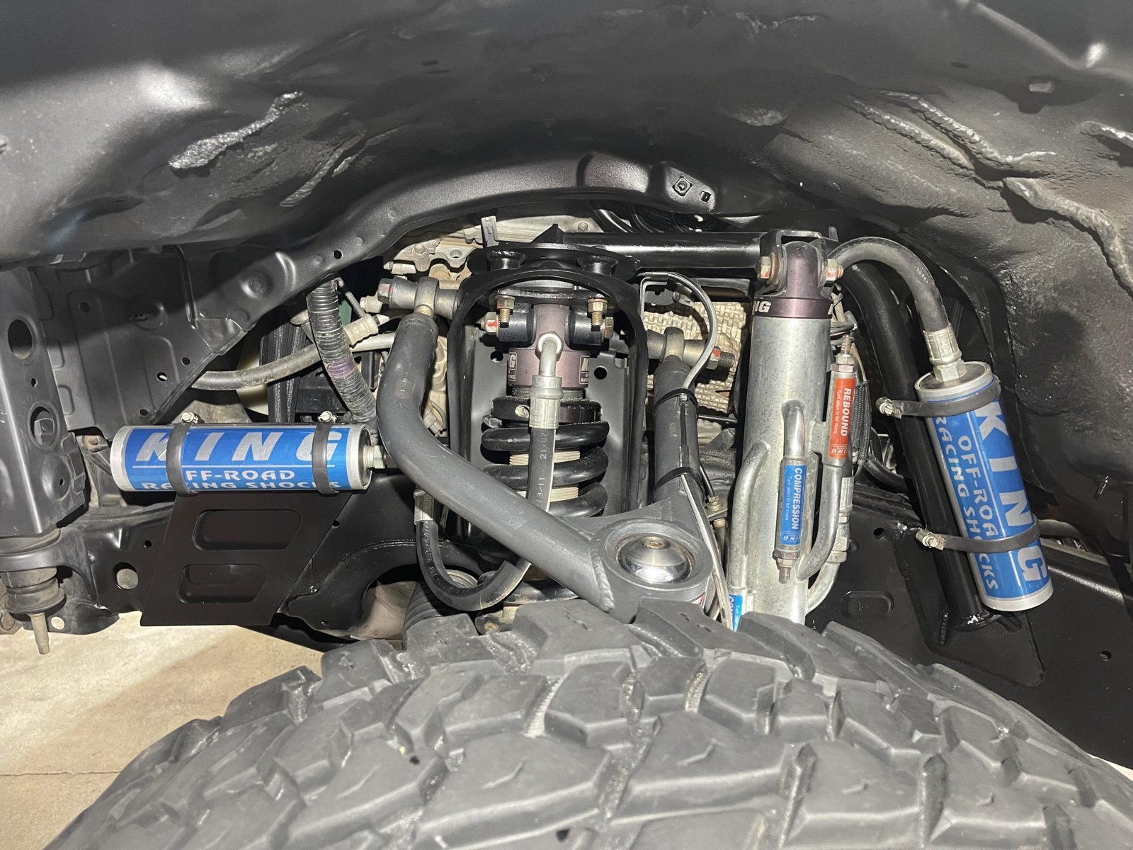

    Check with hotshotoffroad @memario1214. Ask him about your ride, and see what He can do for you.

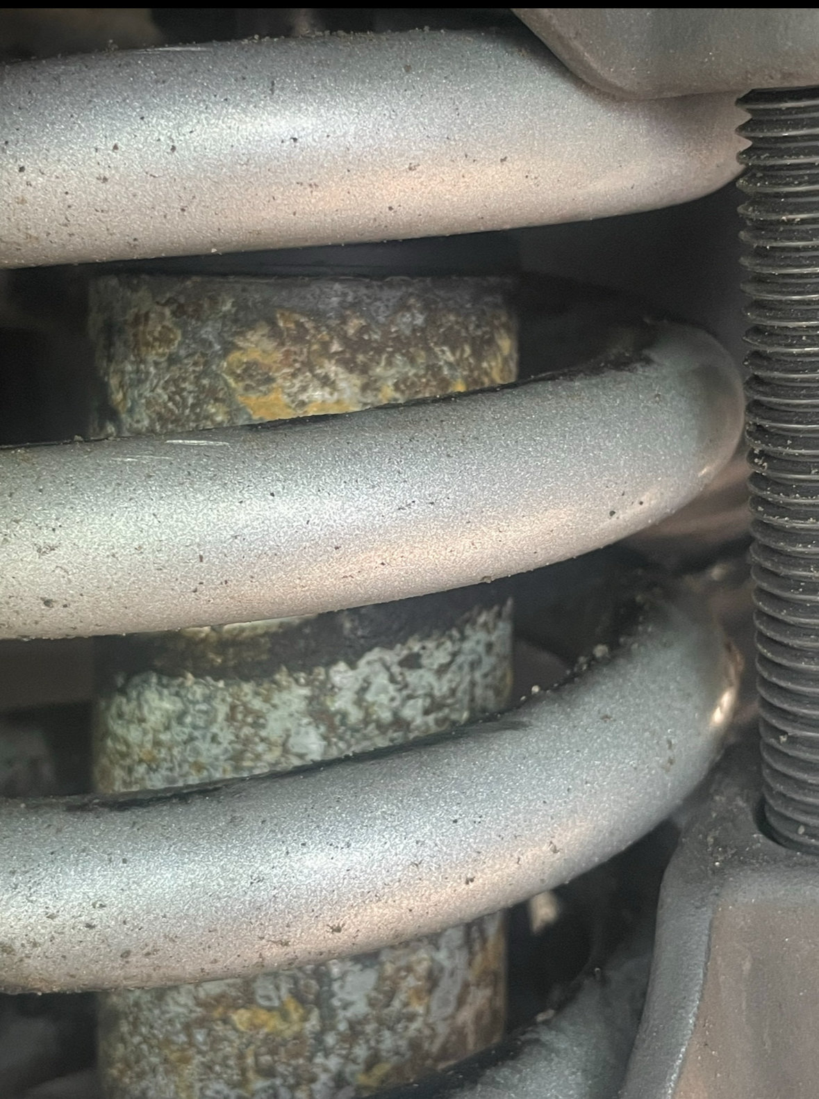

    Fox springs rust like no tomorrow. Do a search around here and it’ll turn up results. Mine were well rusted in less than a year of SoCal driving. Springs are the same for elite or factory race series. Other than that they’re great

    I've heard of the body/threads corroding, but never the springs! It does make sense though!
    Maybe a good idea to prevent this being ceramic coating? Springs corroding are one thing but the shock body I feel is much worse. I appreciate you pointing this out to me though because I honestly didn't even think about that.
    Do you think King springs would be any different?

    No issues on the springs from king

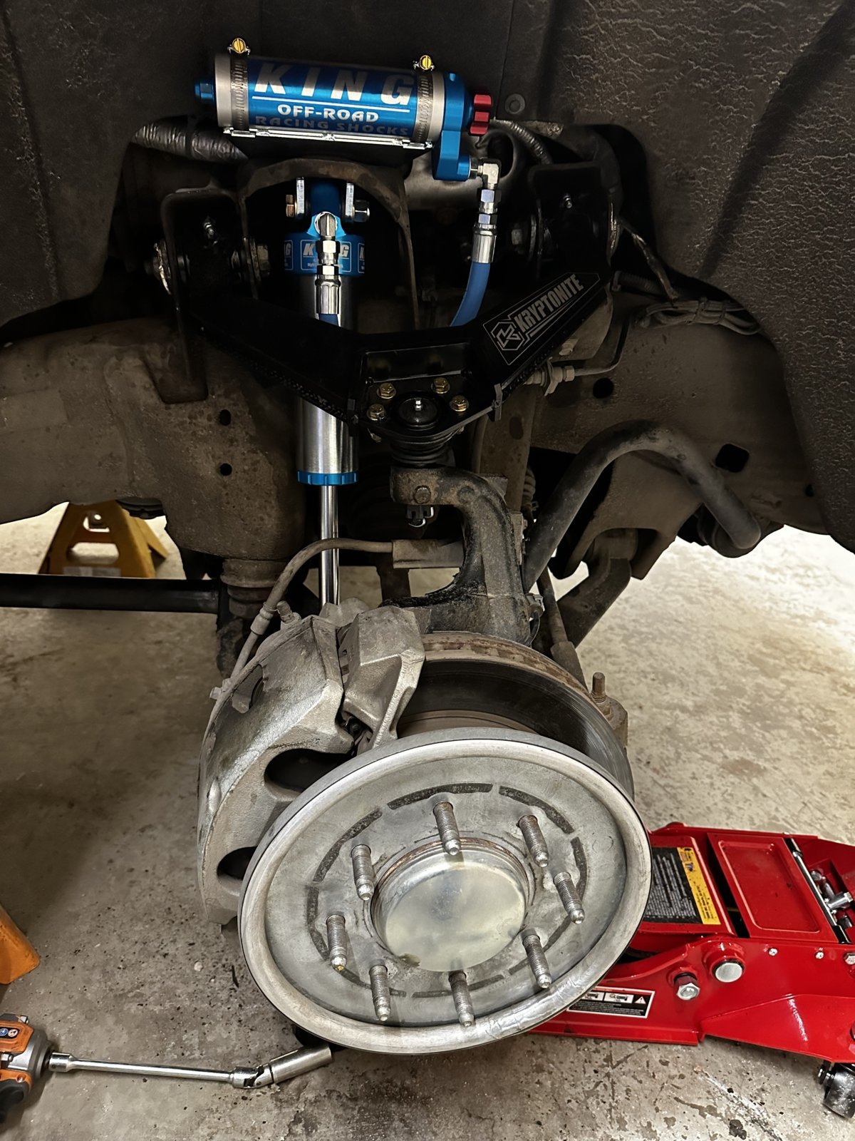

    Hot Damn! Maybe one day I can have a setup like that on a dedicated off road rig!
    Can only dream of finding a RCSB 4x4 in good condition with low miles to do this to :thumbsup:

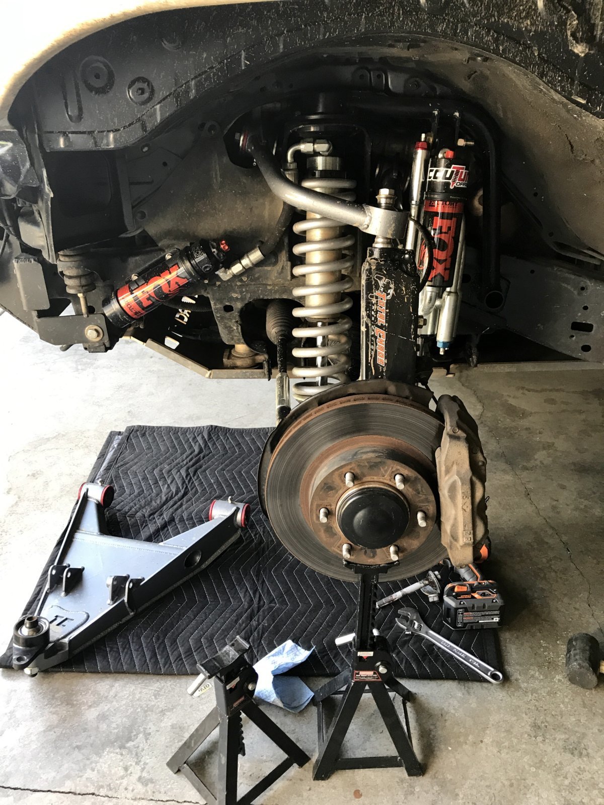

    I had the Fox 2.5's with remote resi's and DSC adjusters on my previous Tundra and I loved them. I had Icon 2.5s on my Ford Tremor and they started leaking oil within a year of street and highway driving under minimal or no added load.
    Icon has also had a lot of complaints about whatever coating they were using as it corrodes very quickly with normal road grime. I believe they have updated the coating but something to check for if you go that route.
    I have some general information on the Foxes from this post forward in my old build thread.

    Believe it or not, I've now convinced a buddy of mine who has the exact same spec truck as mine to do those fox 2.5 performance elites since he too is sick of the blown original shocks. We are pretty much doing the exact same install (JBA uca, <3" front lift, oem rear springs) and I'm actually super excited to see how they compare head to head. There's only so much a spreadsheet can tell you, so actually feeling the difference (in person) is going to be interesting.
    I'll make sure to come back here and share my thoughts and opinions on the two as soon as we get them installed, but I'm sure it'll be a couple months out as he's still trying to justify a $3000+ upgrade to a 16 year old truck. I on the other hand, have already begun :)
    (mind the stereo equipment still haven't found a place to keep the boxes lol)

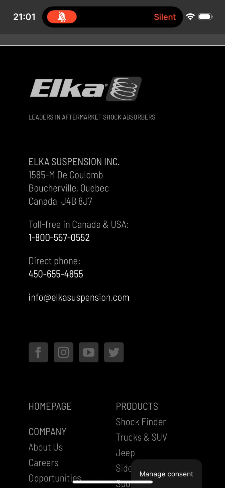

    Are you saying elka has better corrosion resistance? Or being sarcastic?

    No. They are a really good shock choice for the good people in the north. I even think that Elka is a Canadian company.

    These Kings will look good for years. I also wash them off more in the winter.

    Canadian company. They deal with the harsh weather.
