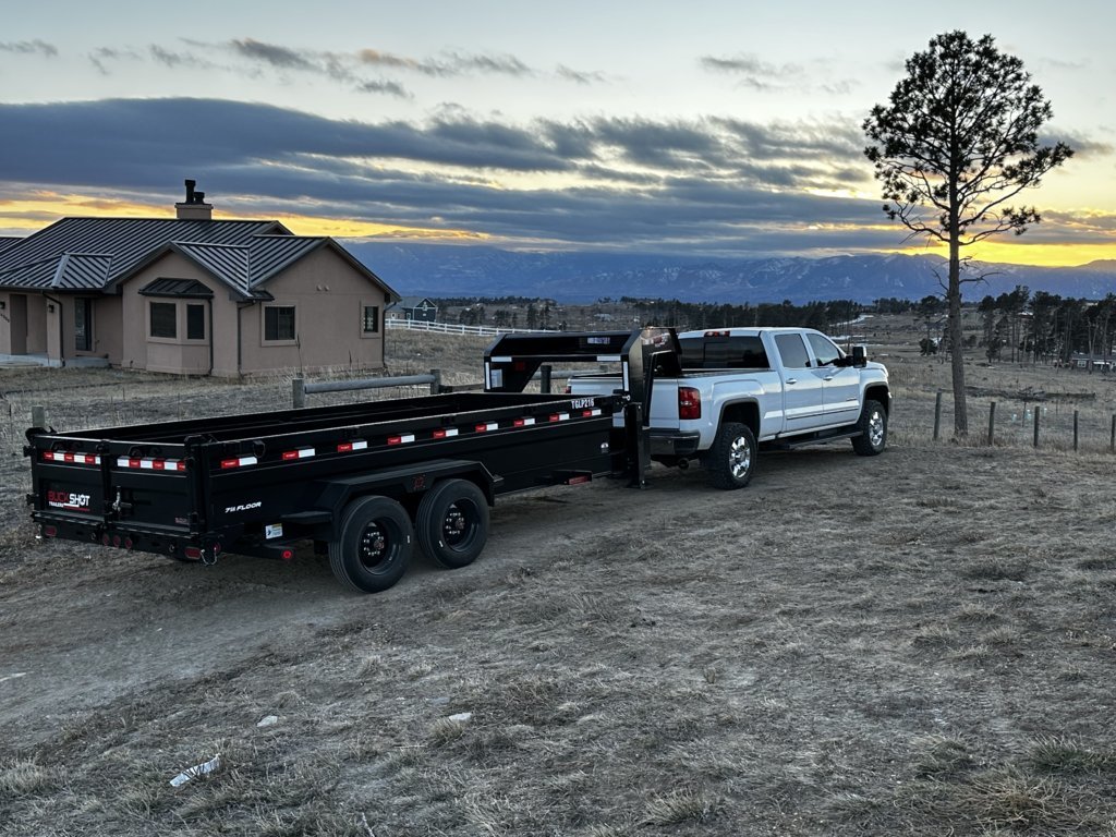

    Want washboard? Enjoy.
    After King 2.5's
    Before King 2.5's
    https://youtube.com/shorts/lO2It8y_3Wo?si=8D-Csk9VblIeUy5p
    This was coming back from Kansas last week towing on what has to be one of the worst roads in Colorado.
    https://rumble.com/v64oy9y-smooth-colorado-roads.html
