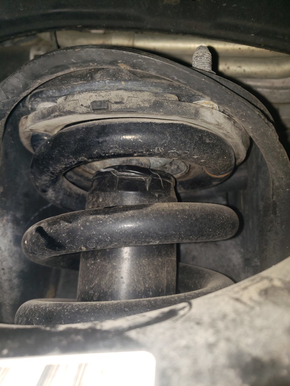

    Hey guys, first post on here so go easy on me. A few days ago while I had the pass. Side of the truck up ( Rotating my tires ) I looked up and saw a big Crack on the top of my strut or shock ! How soon do I need to replace this ? And what brand do you guys recommend? I will change out both fronts but want to know what you guys think . My truck isnt lifted just has a Very heavy front tough country bumper. I'm not paying the dealer another penny. I noticed this 1 week after their "Extreme Saftey Inspection " Please help me out yall thanks! 20191119_171810.jpg 20191119_171810.jpg 20191118_171440.jpg 20191119_171810.jpg 20191118_171440.jpg

    That’s the shock body. Ur probably pay due for an upgrade and one that will handle ur aftermarket bumper. @Toytec Lifts

    I may be mistaken but that looks like the plastic "boot" for the stock shocks. If so, it's not a huge deal. On my truck the actual shock body is in the lower half that bolts to the arm, and the upper part the hat bolts to is the rod end protected by the plastic cover.

    Looks like the plastic cover to me too. Likely nothing wrong with the shock.

    Rock auto is fine, I order parts from them all the time. But honestly if the shock isn’t leaking I wouldn’t replace it.

    That’s all I’m seeing in the pics too, the dust shield crack.
    Replacing your shocks because of age and mileage isn’t a bad idea, but there is no urgent safety issue showing up here. How does it ride / handle on rough road, bridge transitions, etc?
    If the ride is still decent, you have time to let the bank account recover and get better replacements. El cheapo aftermarket shocks are never a good time.
