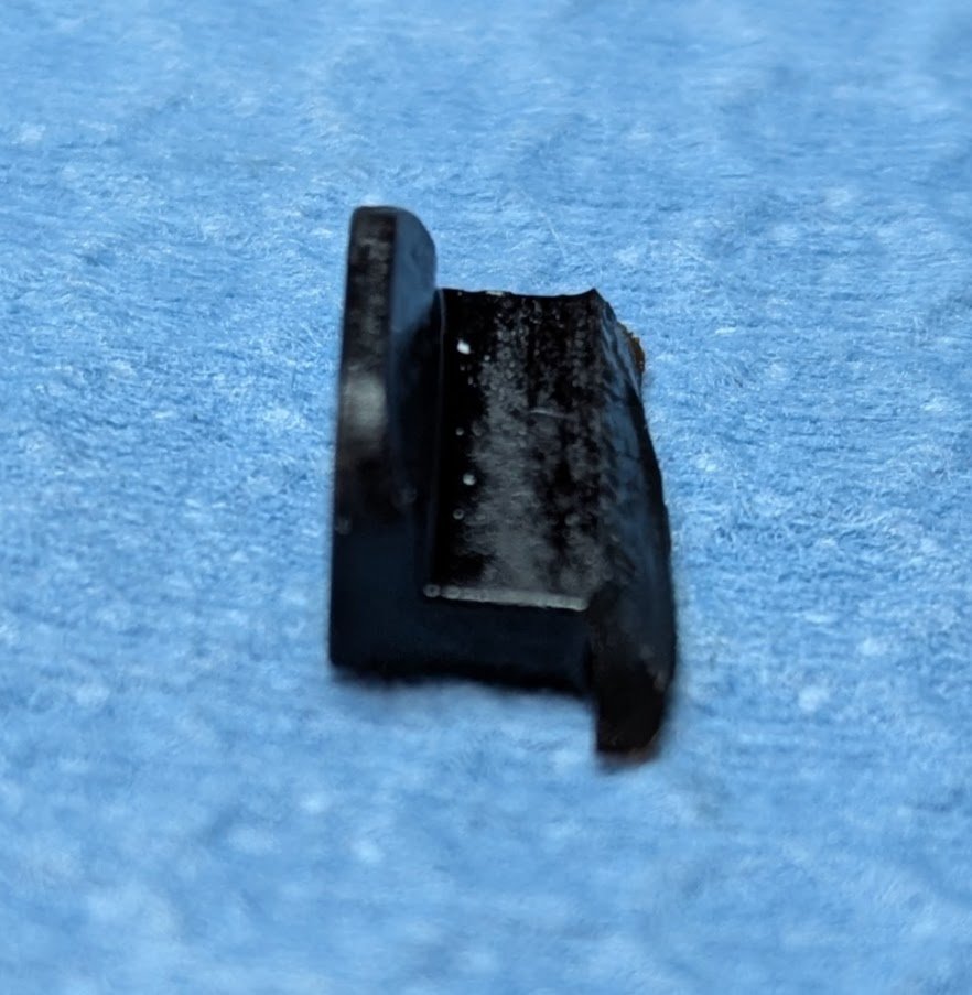

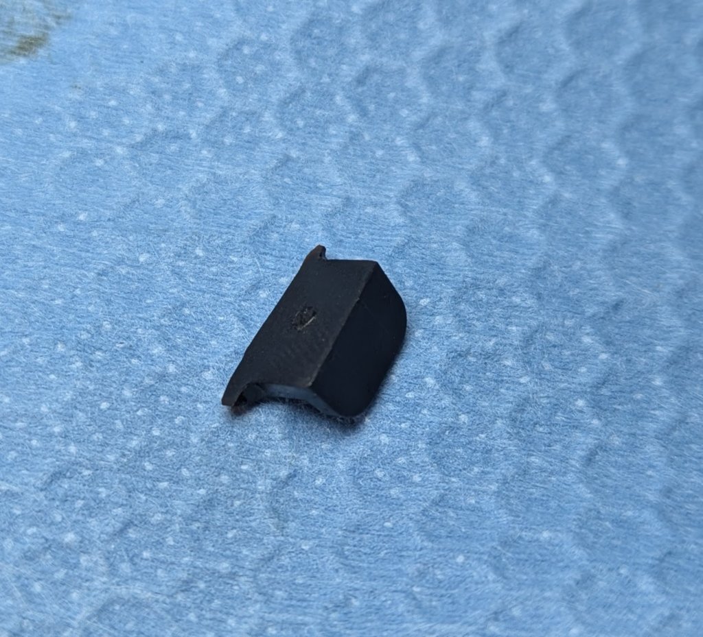

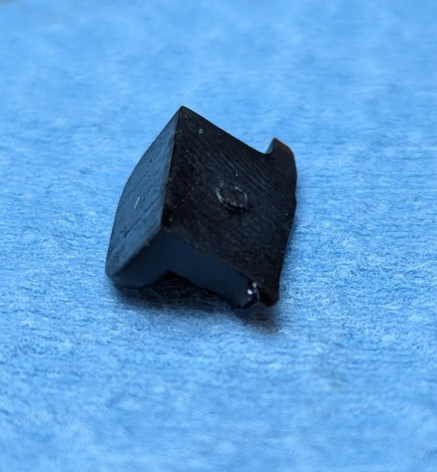

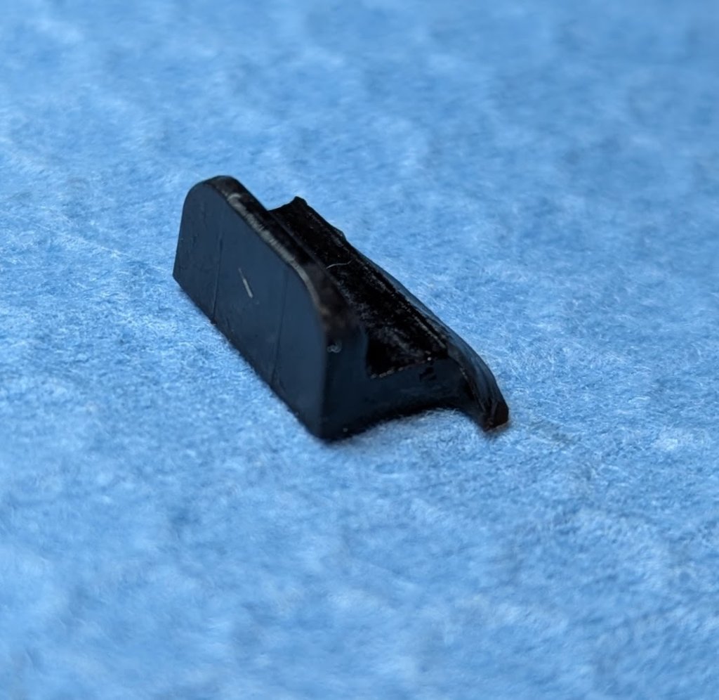

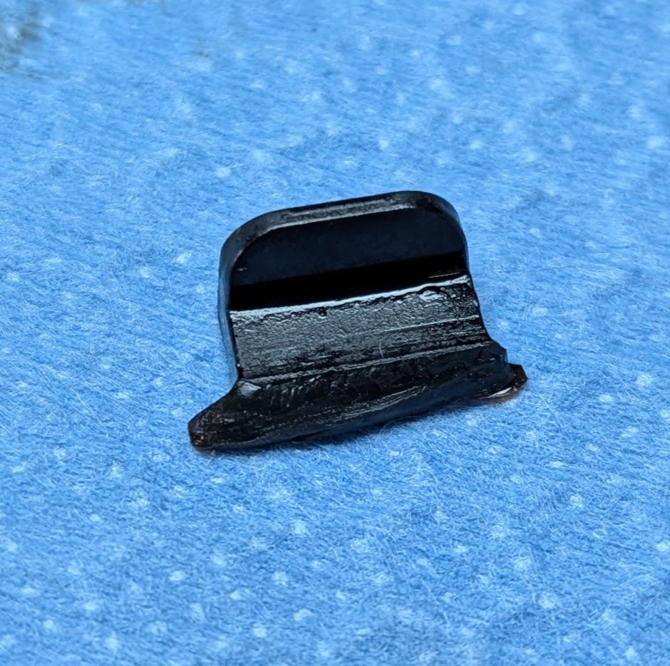

    Found this in my lower oil pan today, it's plastic. Anybody recognize it?

    Looks like a piece of timing chain guide.

    Looks like the bottom part of a chain guide, lower area near the sprocket.

    My first thought was timing chain guide as well.

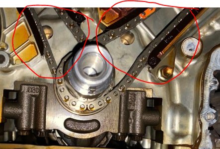

    I'll take you as the final word. Looked at some pics of parts earlier and saw what must be it. Do you think it's trouble?
