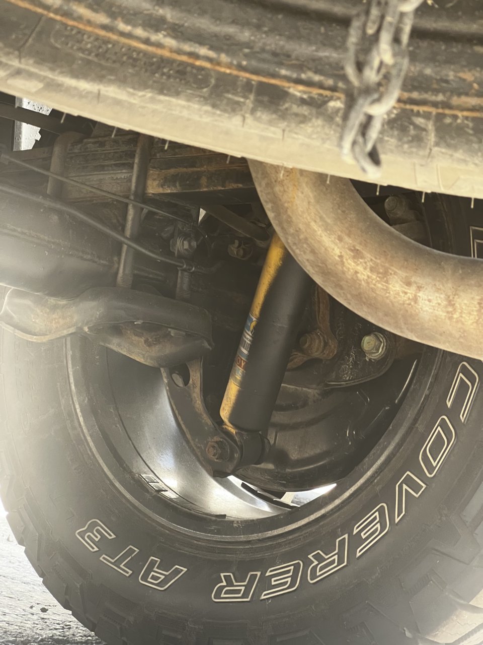

    How’s it going all, found a used 21’ Tundra that fits nearly exactly what I’ve been looking for. My concern is it was a leased car in Quebec, now offered down in Florida where I live. I’m worried about rust. It has the undercoating treatment, I’ve never lived up north so not sure how much rust is too much or what’s normal. How does this look to you, would you consider it or pass? Thank you

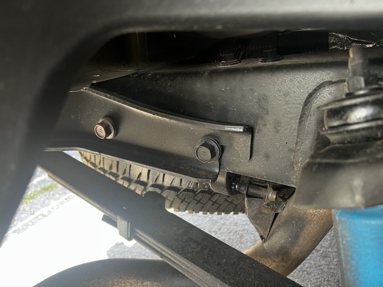

    More pics

    Very little so far
    Good to go. Nothing worry about imo.

    Painted the shocks, I would look closer but most looks like surface rust. Drop the spare and check the hubs and calipers they look a little crusty.

    I’d have it nh oil undercoated and run it. Looks more like spot rust from sitting.

    I think that’s from when they originally sprayed the undercoating on north of the wall.

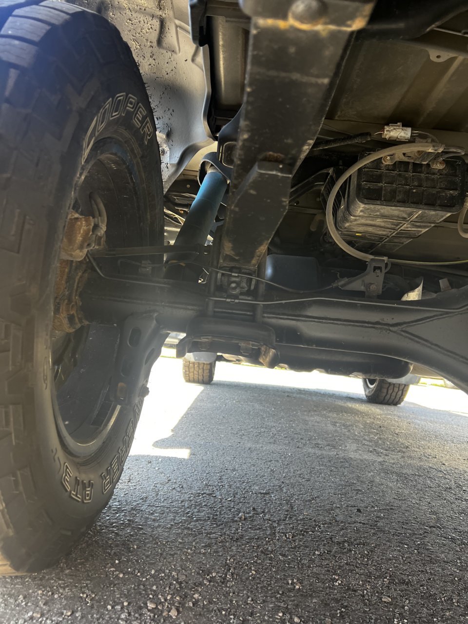

    Can u get pix of the rear diff?

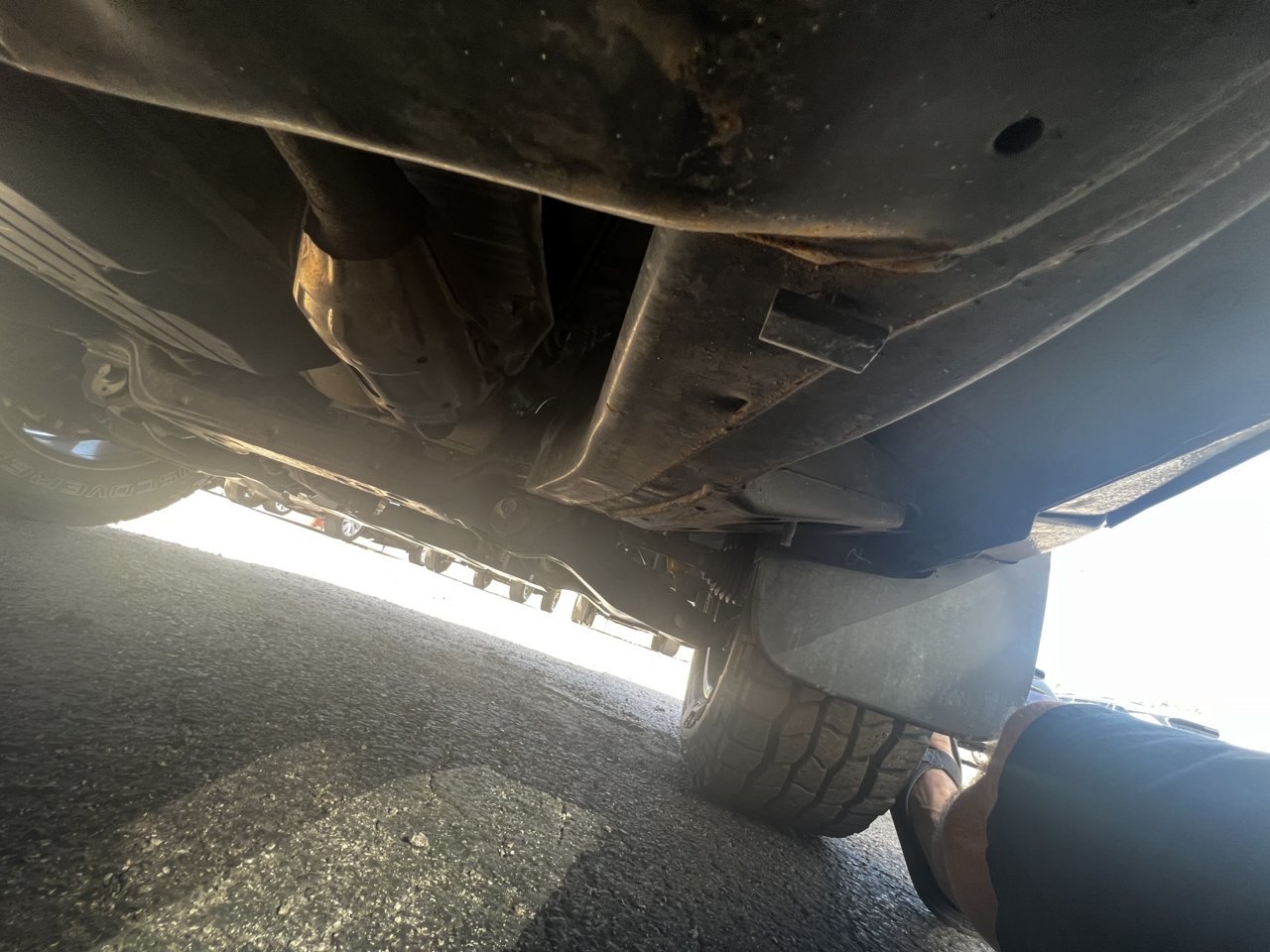

    Well, that's about the crappiest undercoating job I've seen in awhile. There's nothing concerning in those pics, but that does seem like a tad much for a 2 yr old truck.
    Maybe if they'd sprayed a little of that cheap black spray paint on some of the areas prone to rust, rather than all over the shock bodies, it would be in a little better shape.
    The other reason I don't like those half-assed spray paint "undercoatings" is because they spray it over spots that already have rust and then it just flakes off.
    I live in an area that's heavily salted in winter and the worst of it on my 2011 was the rear axel. I removed as much of the rust and loose factory paint as I could and then painted it. With real paint.
    The good thing here is people will usually try to paint the whole bottom of the truck black to hide all the rust. AT least they didn't do that. They just did a shit job of undercoating and now you can see all the areas that need attention.

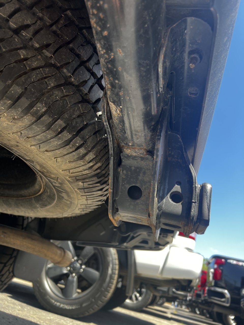

    I'll add, if you buy it, attach a garden hose on the hot water heater and rinse it all down thoroughly with hot water and a decent nozzle. Get up inside the holes, pockets, over fuel tank, etc. That will help dissolve any residual chlorides before you go about any corrections and the hot water will evaporate quicker as well. Again not fun, but worth doing if you want to minimize rusting.
