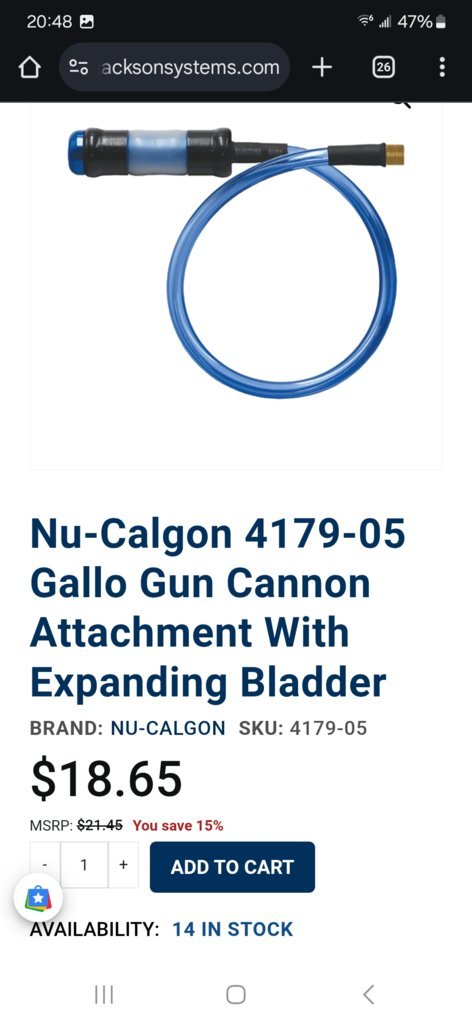

  12. Jan 7, 2025 at 5:55 PM
    Blufin
    Blufin Seasoned member
    Feb 27, 2023
    #92850
    1,284
    Bob
    23 Capstone
    I haven't looked yet,but I will.
    So question for ya,what's the hole opening size and can you get your paws to it?
    I have used Galo guns to blow out condensation lines for AC units the PSI is nominal but enough to clear most lines with out re loading a CO cartridge.
    Again I haven't looked yet, but since you have located the drain port do you think a 3/8" OD nylon tube will fit into it and have at least two fingers to hold the tubing into place while firing?
