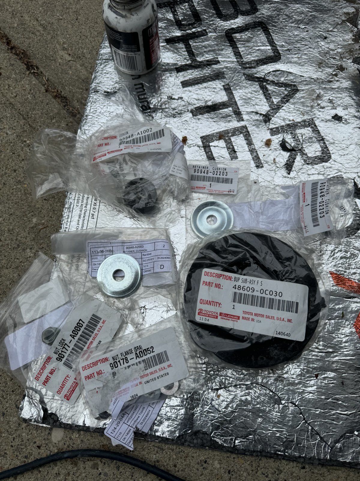

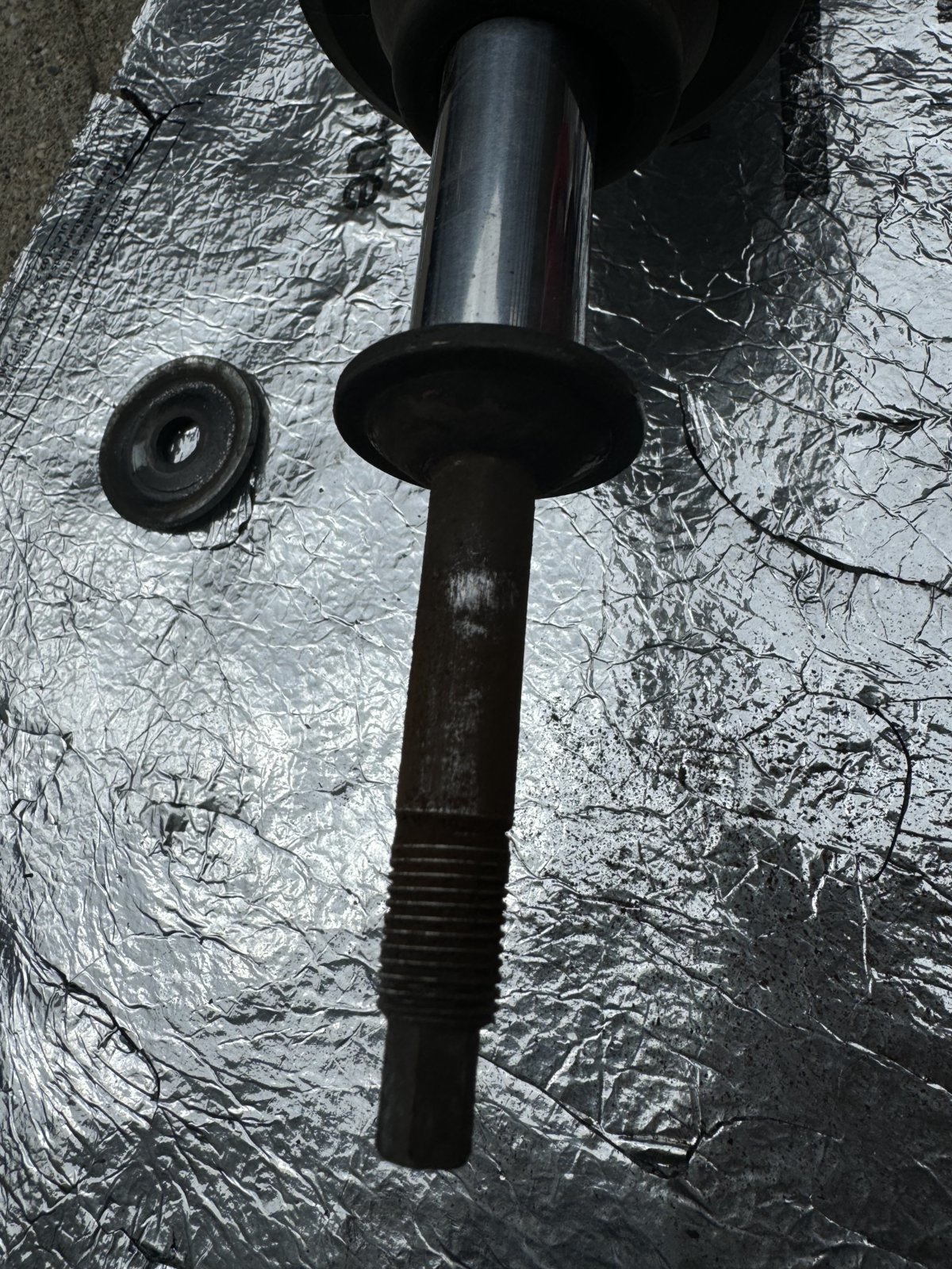

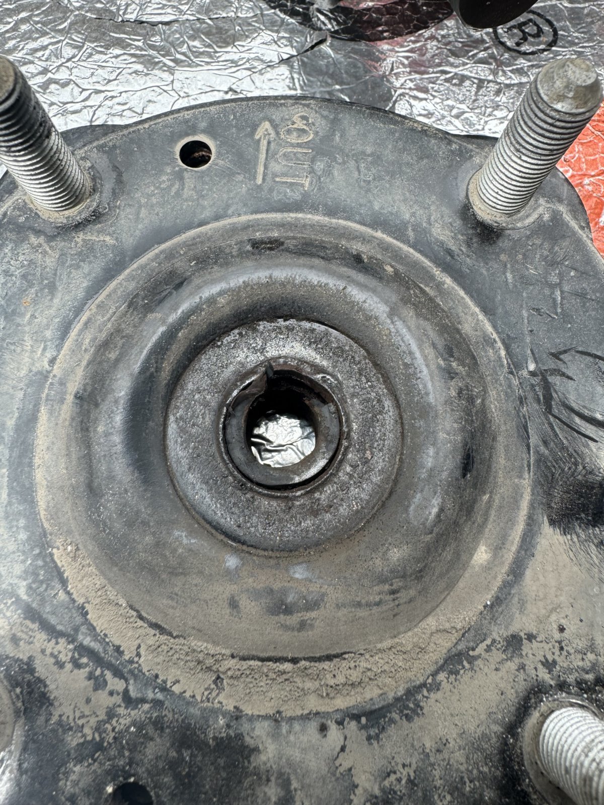

    Ok here is my experience with my clunking situation may or may not relate to everyone but it may help someone.
    The clunking started at around 60000-70000k so after checking everything I torqued all suspension bolts and nuts everything was good, still clunking after listening to the clunking I decided to replaced the stock mounts. When I took the suspension apart the shock shaft wallowed out a hole in the mount and the shaft was banging against the mount and I was super happy that I figured it out, so me thinking i’m just going to buy the KYB mounts for the fox suspension it lasted 6 months and the clunking started again was super annoyed and said F it i’m going to by factory toyota parts. I took the suspension apart again to install the factory parts and the same thing happened again wallowed out the hole for the top nut. I hope this will be the last time I have to do this now that the suspension has factory parts and hopefully it will last at least another 60-70k here are some pictures of what I just did today hopefully it will help others:thumbsup:
    I forgot to mention it was the same on both sides and both were replaced with factory toyota parts
